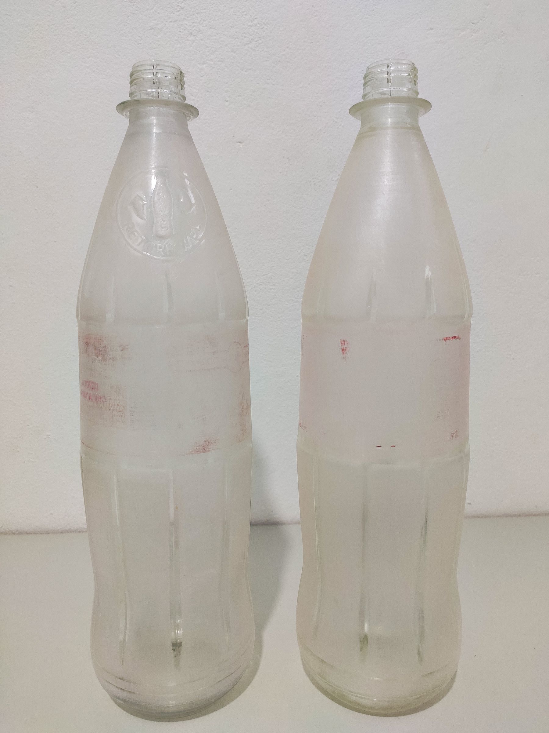

So let's start building the rocket. But first, take the two 1,5 L returnable PET bottles and use sandpapers to sand both bottles. Then let's move to the next step.

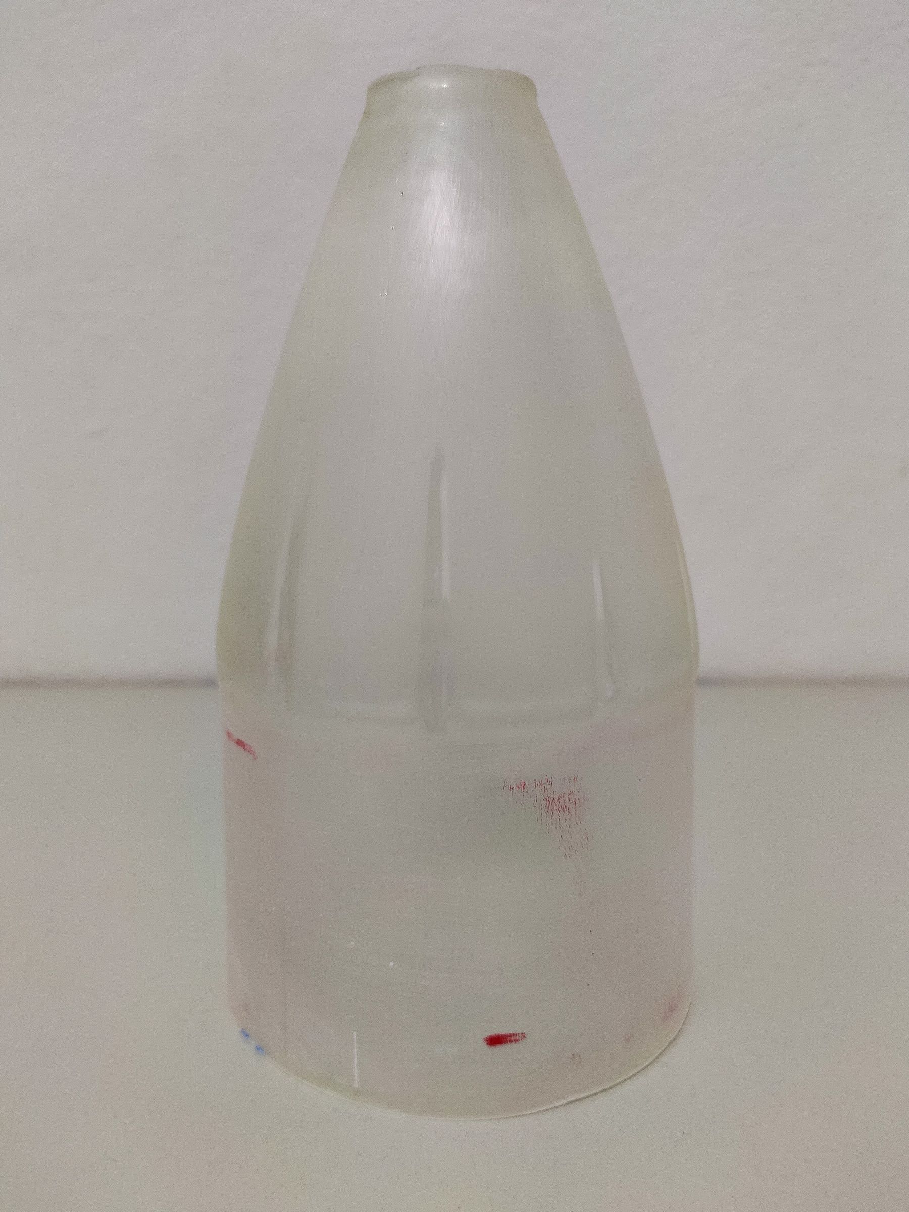

1. Cutting the bottles
Take one of the previously sanded bottles and cut it in the middle, then you will have something like the second image below.
Now we'll have to build the rocket nozzle using the top of the bottle that has been cut, for that you will have to use "Durepoxi" which is an epoxy adhesive and then shape the mass at the tip to form the tip of a rocket with the rest of the bottle, see the image below.
Once you've made it, let's glue this part into the bottom of the other bottle, so wrap the TEKBOND 793 around the bottom of the bottle, then put the rocket nozzle in it and tape around it. Now your rocket is starting to take shape as you can see in the image below.

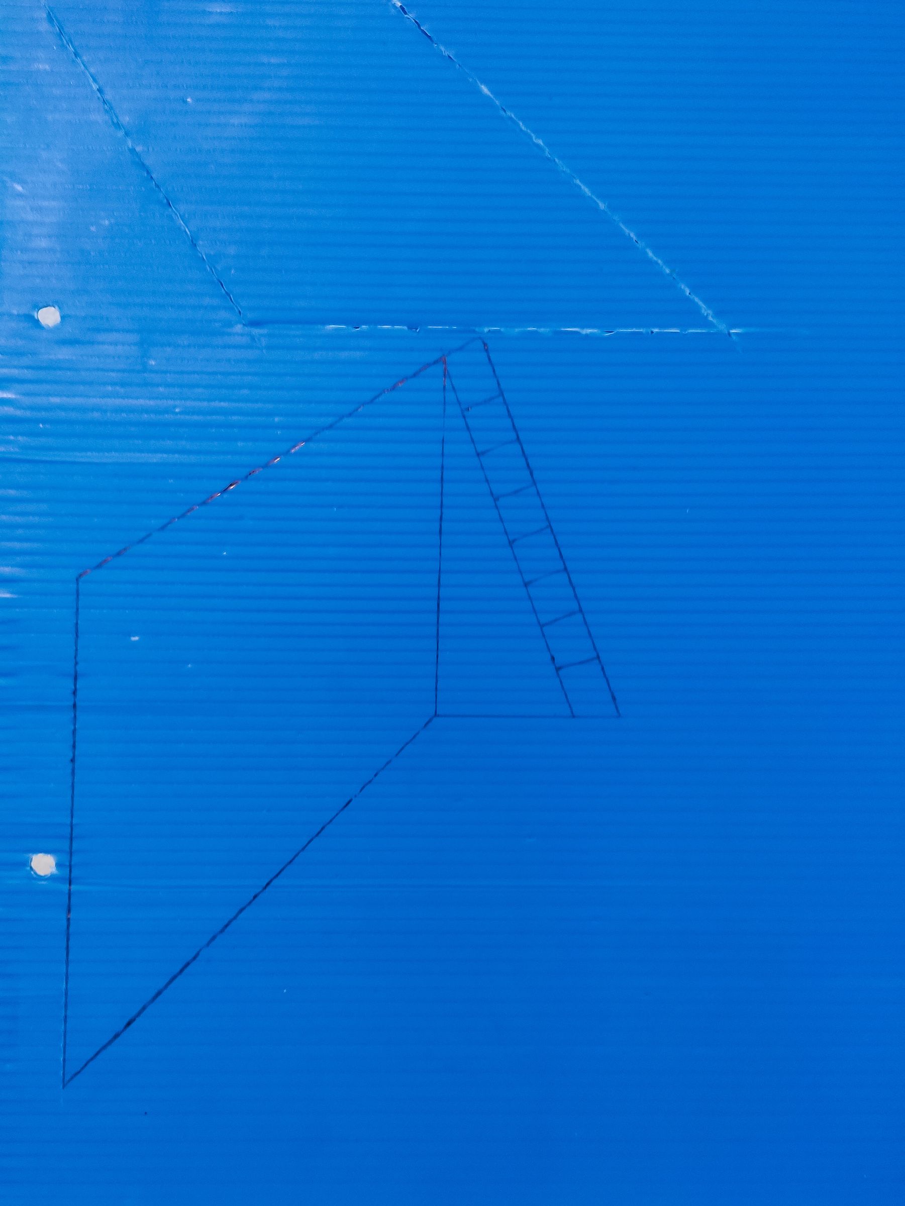

2. Making the Fins
To finish your rocket you have to make the fins of your rocket, to make it you will need a plastic school folder, you can use other materials too, but only make sure that it's a light and rigid material. Exist different tips of fins elliptical, trapezoidal, square, rectangular, etc... In this project, we made 3 trapezoidal fins. See the images below.
When you finally cut the fins put it in your rocket and it will be done. The images below show 2 of our rockets that we launched, on the left, you can see the rocket Canopus and on the right, you have the rocket Andrômeda.
