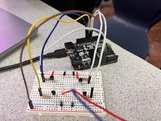

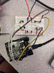

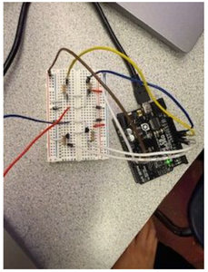

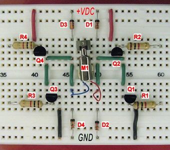

Step 1: Wiring
Important Notes:
When wiring your H-Bridge circuit, ensure your diodes are oriented correctly. As shown in the image above, top transistors Q4 & Q2 are flat side down whereas bottom transistors Q3 & Q1 are flat side up.
To connect the battery to your circuit, attach the positive end of your battery to the top row of your breadboard (labeled +VDC), and the negative end of your battery to the bottom row of your breadboard (labeled GND). (This sets up the power and ground rails)
Step 2: Testing
To try it out the H-Bridge, connect a wire from GND to the right-side of R2. Then, connect a wire from +VDC to the left-side of R3. The motor should spin forward.

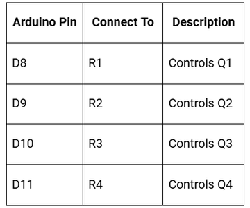

You’ll need 4 available digital output pins on your Arduino to control the H-Bridge, each connected to the base of a transistor through a resistor.
Use the table above to check your wiring:
*Each Arduino pin connects to the non-transistor side of the resistor (R1-R4)*
Also connect:
  1. Arduino GND ➝ Breadboard GND rail (bottom black wire rail).
  2. Arduino 5V or Vin ➝ Breadboard +VDC rail (top red wire rail). Be cautious: if your motor needs more than 5V, use an external power source and only tie the grounds together (don’t connect the Arduino’s 5V pin to the power rail on the breadboard).
