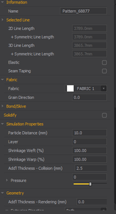

By clicking on the pin on the back, you can delete the pin so it is no longer being held. Now its looking more like a scarf. To give it more polygons, click on the attribute panel and lower the "Particle Distance (mm)" number. It was at default 20 but I reduced it to 10 to give it more geo.
