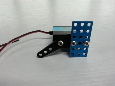

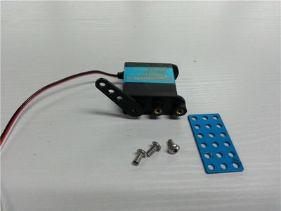

Step 1: Build the Drive Part 1
Part List:
1 x Servo
1 x Plate 3x6
3 x Screw M4x8

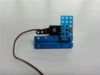

Step 2: Build the Drive Part 2
Part List:
1 x Beam0824-080
1 x Beam0824-024
2 x Nylon Lock Nut 4mm
2 x Screw M4x22

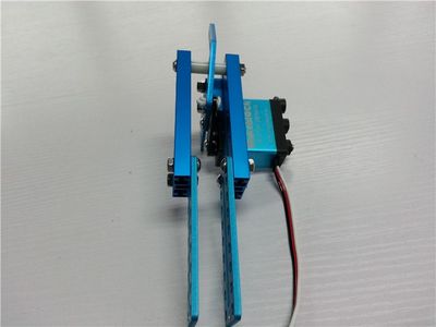

This extension structure

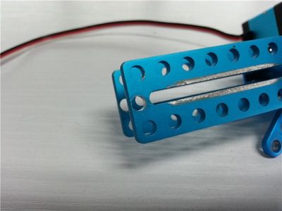

needs to drive thru linear motion, hence we used plate l1 as a guide rail and used plate 45°to transform the circular motion of the servo into linear motion.
Step 5: Build the Drive Part 6
Part List:
2 x Plate I1
4 x Screw M4
4 x Screw M4x14
Note: As showed in the picture 3 in this step, we need to drill a 4mm hole at the end of plate l1
Following the steps, we finished building the drive part.

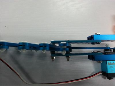

Step 9: Connect the Extension Arm and the Drive Part.
Part List:
2 x Screw M4x30
Several Plastic Spacer 4*7*2

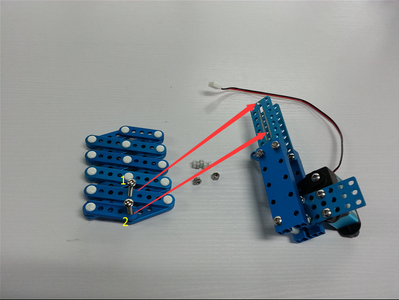

Step 10: Fix Screw Number 1 and Screw Number 2 Separately Into the Hole and Groove of Plate L1, As Showed in Picture Below:
Step 11: Note: the Plastic Spacer Here Is to Parallel Two Plates. the Quantity of Plastic Spacer Used Here Depends on Actual Situation.

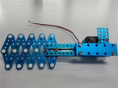

Following above building
steps, we finished building the scissor-type extension arm.
This extension arm can be mounted onto Starter, Ultimate, mBot or other Makeblock robots.
