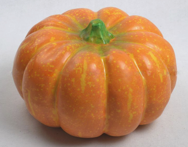

First of all, prepare a small to medium-size pumpkin.
You can buy a real pumpkin from the grocery store, but here I just got a artifial foam-filled one. And of course, to carve a creepy face on it we would need few tools like:

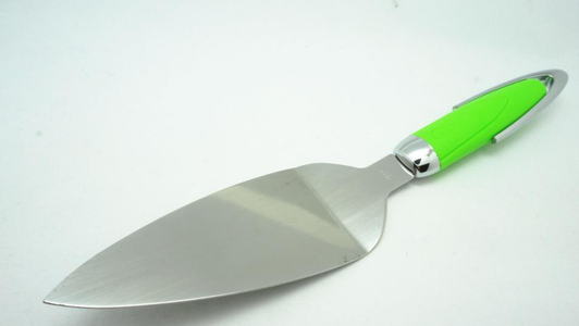

  • Cake Knife

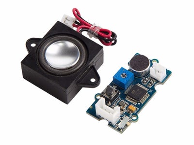

And to make it able to scream we need electronic parts as follows:

  • Grove - Recorder ---- to D4

After everything is set up, you can press shaft Rec on Grove - Recorder to start recording sounds. The recorded sounds will be played when the program runs.
Now you can scooping out the foam inside the pumpkin and set the hardware in it, make sure the speakers is placed a little higher than the others, so it can hold up the upper half of the pumpkin to create an open mouse effect.
