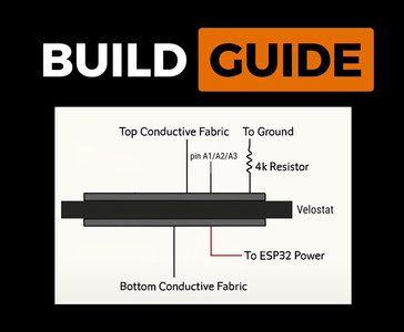

  1. Voltage Divider: This circuit creates a voltage divider. The Velostat acts as a variable resistor (R1), and the 4KΩ resistor acts as a fixed pull-down resistor (R2).
  2. No Pressure: When you are not pressing the sensor, the Velostat has extremely high resistance. The pull-down resistor pulls the voltage at pin A1 very close to 0V, so analogRead() will return a low value.
  3. With Pressure: When you press down on the top fabric, you squeeze the Velostat, which dramatically lowers its resistance. This allows current to flow from the 3.3V pin through the Velostat. The voltage at pin A1 rises significantly.
  4. Result: The harder you press, the lower the Velostat's resistance becomes, and the higher the value you will see from analogRead(A1).

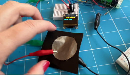

Step 2: First Conductive Fabric Piece
We are essentially making a sandwich of elements!
Look at the diagram, which shows our 'sandwich' of elements. For the first part, we will:

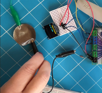

  1. Take one piece of conductive fabric and attach a connection from your microcontroller's POWER pin. Using a crocodile clip to prototype is the quickest and easiest way to get started. If we prototype it first while we check the code, then you can integrate it into your own completed circuits.
That's this step done.
Put this piece aside for a moment.
Step 3: Second Conductive Fabric Piece

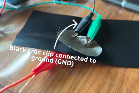

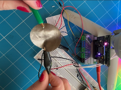

Take the second piece of conductive fabric, and this one we need to attach a few more connections.

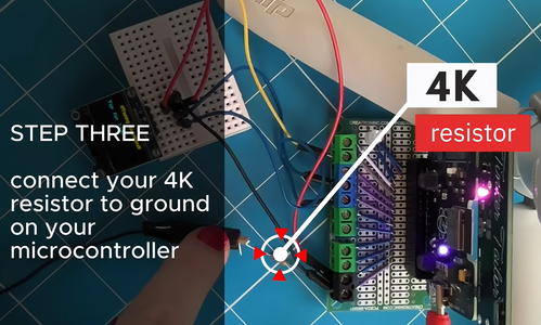

  1. connect this piece to GROUND - but before you connect ground, take a 4K resistor - this should then connect to your microcontroller's ground pin
  2. from the microcontroller's ground pin, through the 4k resistor, then attach the end of this ground connection to your conductive fabric piece
  3. also connect an analog pin to this same conductive fabric piece
Choose an analog pin,
For this circuit, we need to record a reading of different values. If we used a digital pin we would only get 1 or 0, so no variance.
This circuit relies on getting the various values. We use these values to then control components connected to the microcontroller.

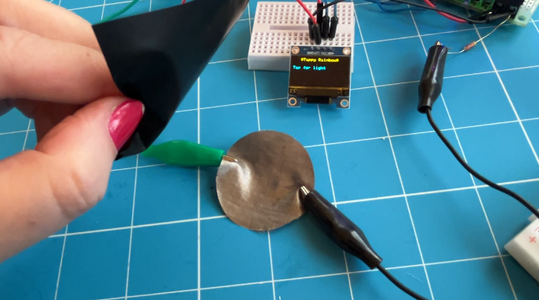

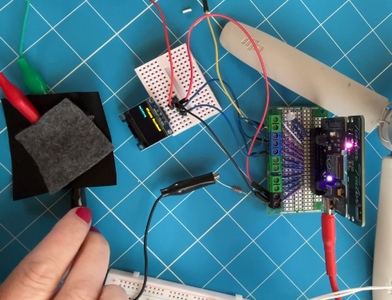

With both pieces of conductive fabric connected to the microcontroller, we can now layer up our sandwich!

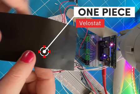

  1. Place one of the conductive fabric pieces at the bottom
  2. Place the Velostat on top of the conductive fabric
  3. Place the second piece of conductive fabric on top

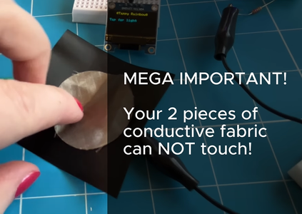

IMPORTANT: Make sure the Velostat COMPLETELY covers BOTH the conductive fabric pieces. The pieces of conductive fabric cannot touch or it will create a short - or an undesirable, unpredictable circuit.
If you are unsure, please refer to the diagram in step two.

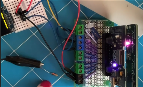

Step 5: Upload Code to Your Microcontroller
Now that our awesome pressure sensitive button is complete - I'm uploading my code to the board.
I added an OLED at this step so I can get a read on the touches and taps, but this is optional. You can use the serial out to view messages instead of this.
I won't go through the code in detail here, but the code is on my GitHub, and it can be used for the Arduino IDE, or PlatformIO too.
cmoz/TappyBag: Modded handbag with WS2812s, ESP32C3 mini, OLED, and a button from conductive fabric and velostat
The effect that this button is programmed for (and you can edit it for your purpose), is that if you tap it lights up an light strip (WS2812b). The longer you hold the button, and keep it pressed, the more lights will light up. Once they are all lit, then there is the rainbow effect.
Releasing the button will turn off the lights.

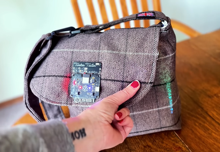

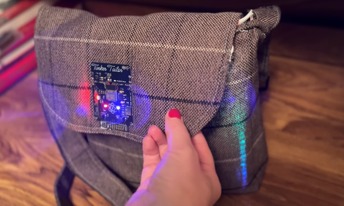

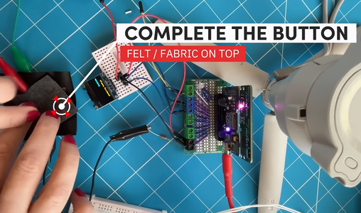

Step 6: Design Your Button to Suit Your Style
You can choose fabric; I like felt for wearable technology, to cover your button so you can put it into your circuit.
As shown in the photos - I'm embedding mine straight into my handbag so I'll sew felt around the button to protect it before I embed it.
