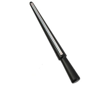

I do the same texture on the ring and shape it with a ring's steel mandrel.
The most common size of rings is 7.5 (approximately 18 mm). To measure that, I use a simple measurement mandrel.
