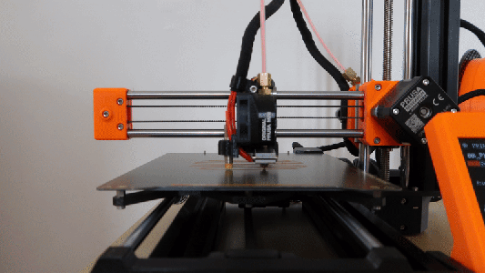

After some iterations, I ended up with a very simple base design; a 3D printed frame for the wing, a paper straw as the main body, and a paper tail. The total printing time is a little more than 1 hr (depending on your 3D printer and how big you make it) and the assembling process takes a few minutes (although you should let the glue dry for a bit longer).
