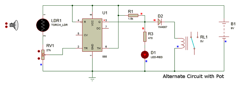

Step 2: Circuit Diagram
I have shared two circuit diagrams : one with the pot & one without the pot
1. One without the pot : for this i determined the value of R2 by trial & error method. This value senses the dark exactly at the time of sunset
2. One with Pot : this gives you the option of changing the sensing according to your convenience at any given point of time
