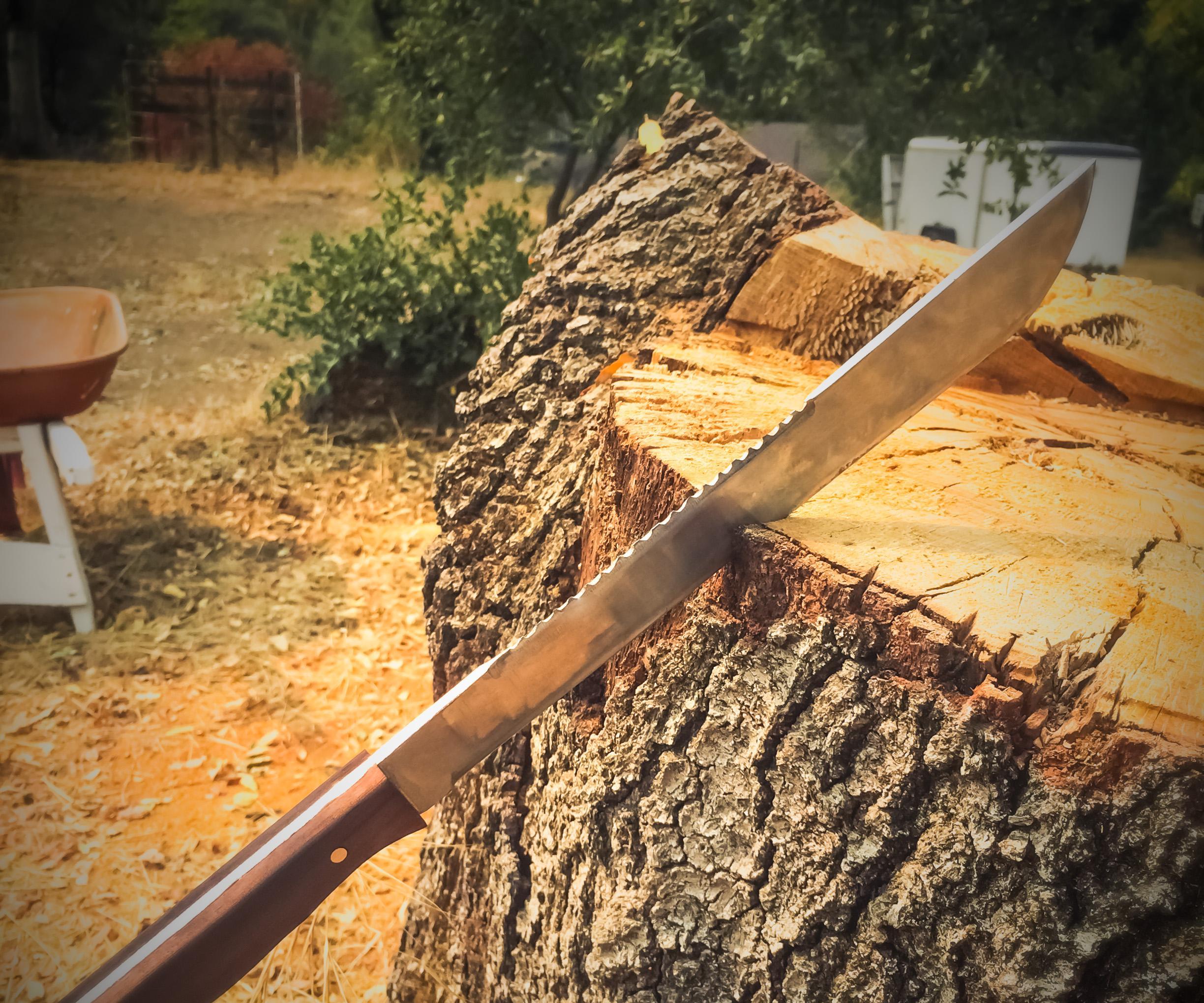

Introduction: How to Make a Simple Hunting Knife
About: My name is Owen Schafer, I am 14 years old. I like making knives, woodworking, and metalworking.
Usually, when I make knives and swords, I take ideas from a tv show like forged in fire, A video Game, or Another Blade from history, like a samurai sword or a greek kopis. This time though, I decided to make something simple and small. The reason I decided to do this is to see if I would like it more or less than the other things I choose to make. If you ever feel kind of like trying something but don't think you'll like it, just try it. More often than not, you will like the thing you try, and this is the entire reason I started knife making and making Instructables, both of which I enjoy doing very much.

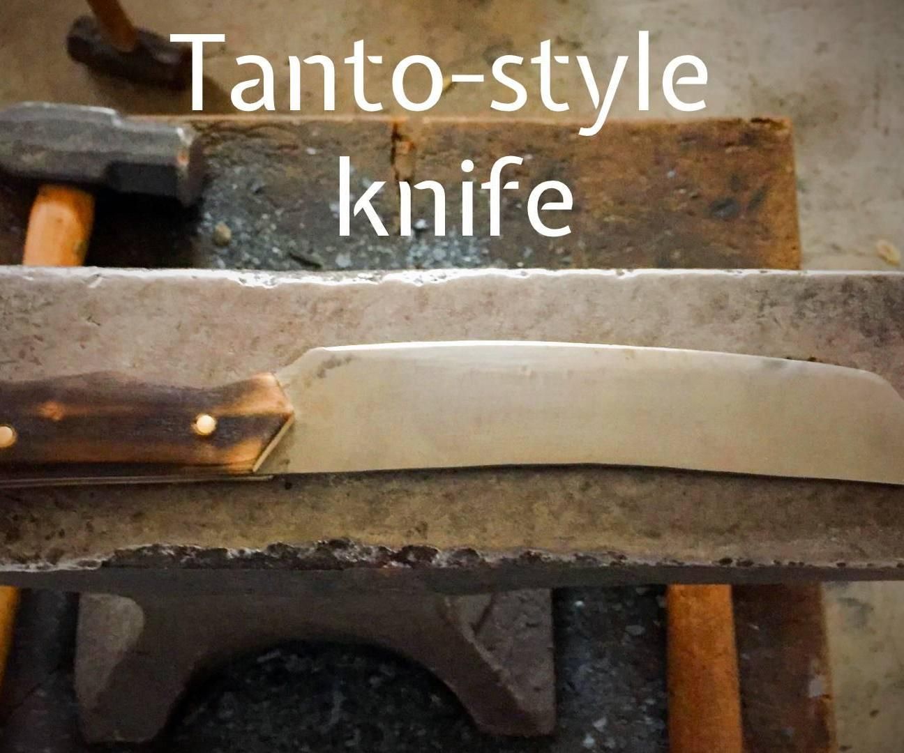

Normally, I grind my knives to shape because I think it gives a better and faster result, but this time I decided to forge my knife to shape instead. (If you don’t have a forge, don’t worry, you can still just grind out the shape. I just forged this time to try something new.) I am not as good at forging as I am at grinding, and I want to get better, so that is another reason I decided to forge rather than grind.

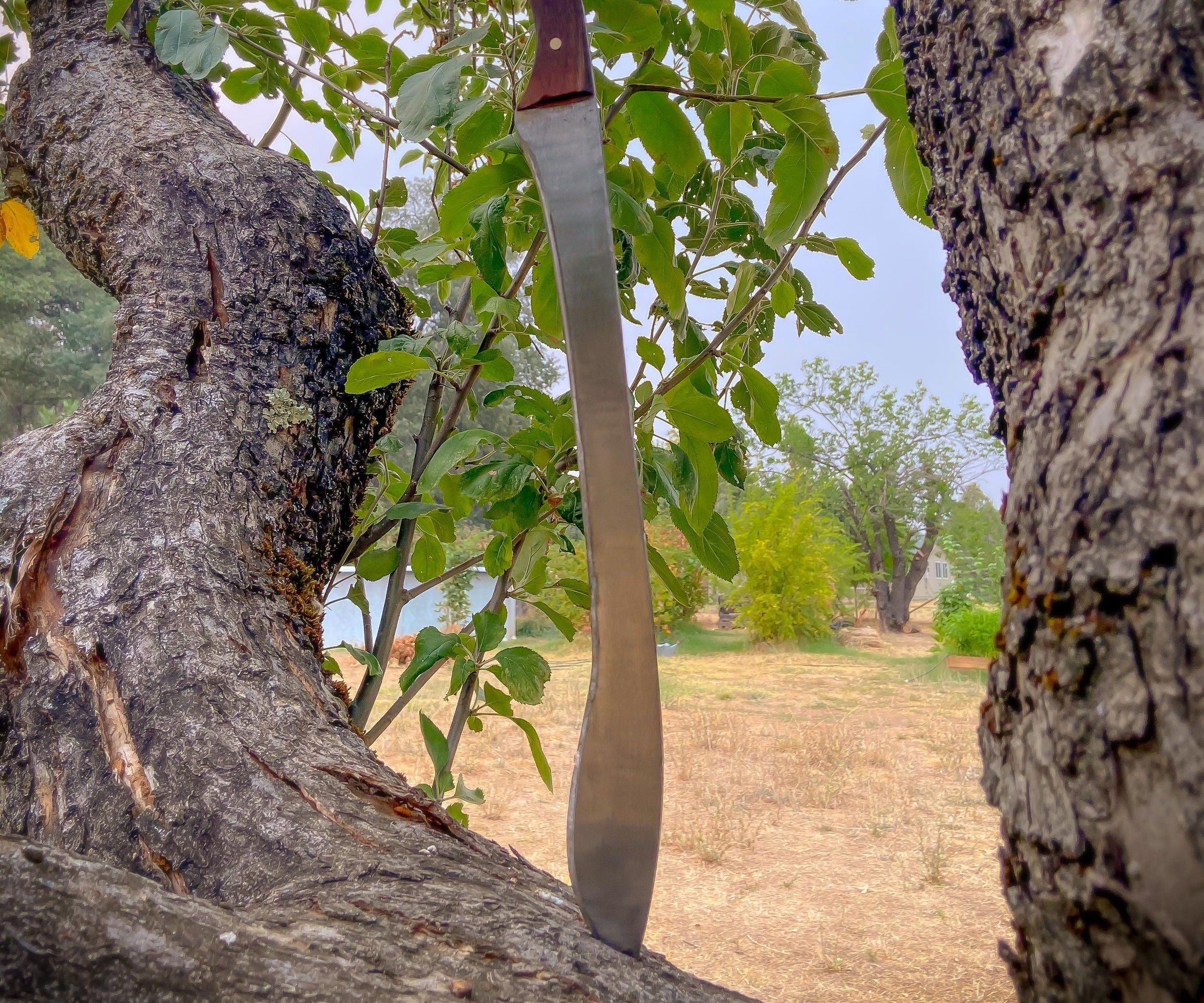

To assemble the handle you will need your handle material, a 3/16 inch brass rod, and your 5-minute epoxy. First, you mark out the shape of the handle on your handle scales and mark the holes on the tang. After cutting the handle scales out, (you can use a band saw or a jigsaw) drill holes out on the markings that match the holes on the tang. (Make sure to use a 3/16 inch drill bit) Then, cut two pieces of brass rod to about 25 mm each. After that, put the two pieces of the brass rod through the handle scales and tang, and glue it together with 5-minute epoxy. (If you clamp it while the epoxy is drying, it will hold together much better and be stronger.) After the epoxy dries enough to hold the handle together, use a belt sander or an orbital sander to round off all of the uncomfortable edges until it feels nice to hold.
