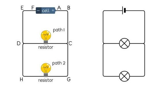

A parallel circuit is a circuit in which there is more than one path for electricity to flow. A great comparison of electricity is a river. A river that flows and then branches off into smaller streams that all come back to the same point forming the river again is the same concept as a parallel circuit.
How is a Parallel Circuit different than a Series Circuit?
A Parallel Circuit is different from a series circuit in the way that if a component such as a light bulb, LED, or resistor fails the circuit is still active. The electricity flows around the break in the circuit and branches to the parallels. Another characteristic of a parallel circuit is that voltage of the circuit is the same across any point of the circuit where it is measured.
