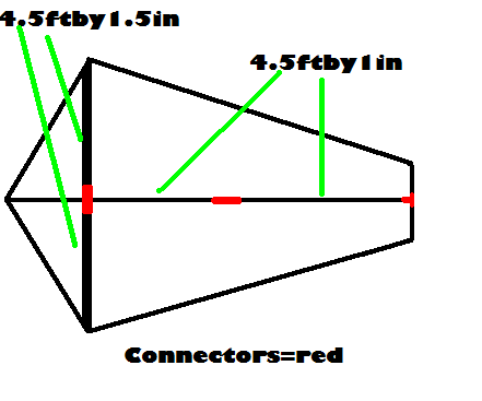

-2 pieces of 4.5 foot long 1.5 in. PVC and a connector to join them
-2 pieces of 4.5 foot long 1 in. PVC and a connector to join them

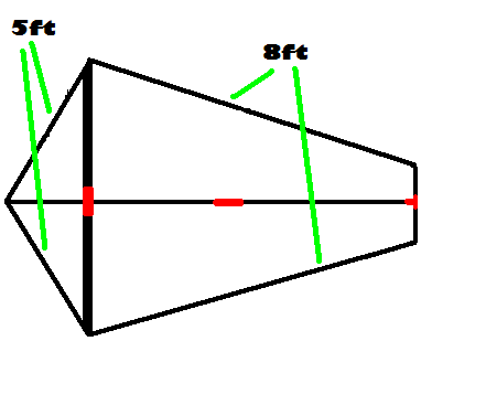

Assemble your PVC as seen in the diagram
Properly lay out your PVC on your plastic/tarp and draw lines from end of pipe to end of pipe, or trace the diagram onto your plastic/tarp
Cut out the shape, larger than necessary, you can cut off excess later

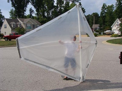

Unless you used clear plastic for the whole thing you can't see anything if you hold your sail in front of you, so you need a window.
Decide on your shape for your window(I chose the SSB emblem)
Trace it onto your sail and cut it out
Cut out a piece of your clear plastic and attach it to your sail where your window is, this is where I used the hot glue gun because it looks better
Cut off excess

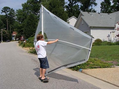

Step 4: Using the Sail
Assemble your pipes
Put them on the sail
Lash your two pipes(horizontal and vertical) together with your rope(wrap the rope around them until they stay together and then tie it off)
Take the sail outside
Stand on your skateboard
SAIL!
