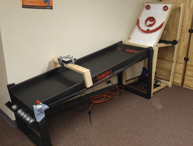

The assembly of the machine is split into two different units: the ramp unit and the board unit, one containing the ramp and one the backboard. The two are placed closely together to play the game.

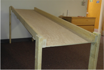

Step 3: Build the Ramp Unit
Cut all necessary wood pieces to the correct length. Then begin by constructing the two legs of the ramp, connecting the three main 2x4’s for either side. Then carefully attach the ramp board by screwing along the longer 2x4 between the two legs. Add support beams at the front and back, the ball catcher at the front, and the ball-hop at the end.

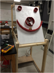

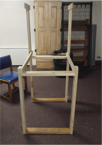

Step 4: Build the Board Unit
Cut all necessary wood pieces to the correct length. Use a 3” circular saw to cut holes in the backboard for the balls to go through. Begin by building the frame of the unit, attaching all of the outer 2x4’s to establish the base, as well as the longer one that supports the board. Carefully lay the board on top of the support, and screw it in at the top and bottom where it meets the support beams.
Step 5: Build Mount for Projector
Take a "1x3" plywood piece and two pieces of any left greater than 2". Attach parallel to the "1x3" plywood piece and screw in the 2 same pieces as you can see in this image.

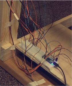

Step 7: Complete Wiring
Begin by taping both the receiver and transmitter parts of the sensors to each hole, as shown in the pictures. Feed each wire along the edge of the frame to the breadboard. Attach each red wire to power, each black to ground, and each white to an analog port. Then connect a computer to the Arduino and execute the code. Also add 6 resistors of 10k Ohm each. Resistors are important because otherwise, the Analog results will be fluctuating constantly. But with resistors, light values are much more clear (and it is easier to give a specific value to code when reading a value of 15 or whatever is read when a ball goes through holes after final set up).
A Fritzing is attached to show you where to place the ends of wires and resistors.

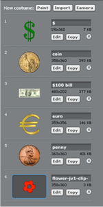

Step 9: Download Images for Your Theme
Begin by downloading images of the costumes you need. The best images are the images with a transparent background, however it is possible to crop out the background in S4A. Create the number of sprites that is appropriate for your design and add each costume to the appropriate sprite.

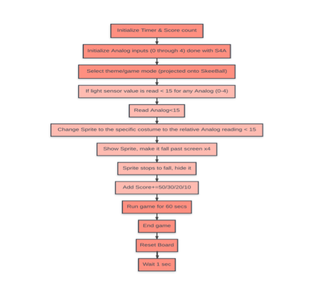

Step 10: Begin Code
Once the costumes are added, you can begin writing code for each costume. If your costumes are “raining” down the screen, as in the money screen, program each sprite to glide from the top of the screen to the bottom in a specific time interval.
Step 11: Code the Game!!!
