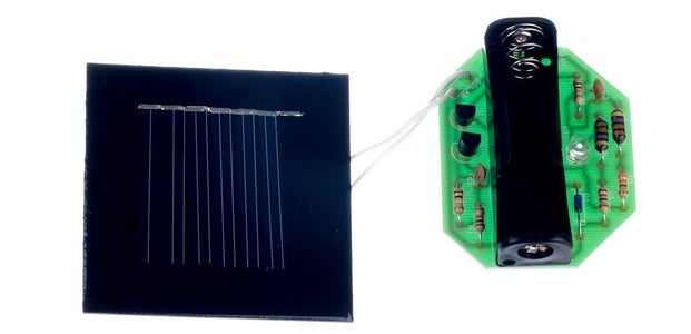

- 1 x Solar Garden Light with Battery.

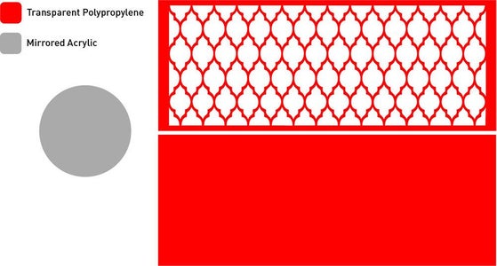

- 1 x Sheet of Transparent Polypropylene.
- 1 x Sheet Silver Mirrored Acrylic.

Assemble your Solar Garden Light Kit, making sure to thread the wires from the solar panel through the hole in the lid. A PDF guide for building the kit is attached to this step, for reference.

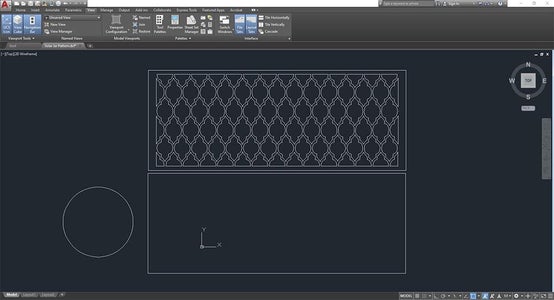

You may need to tweak our design to fit your jar. Just load the DXF into your CAD software and adjust accordingly.
Step 4: To the Laser Cutter!

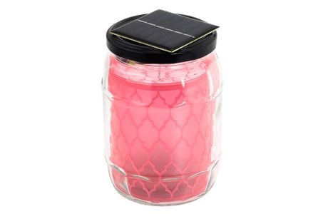

Cut the DXF out as above, and roll them up into the jar. It can go either way around, though we have put the solid sheet on the inside and the patterned sheet on the outside.
Step 5: The Finishing Touches

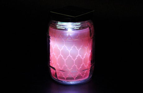

Pop the lid on, with the kit in the jar, maybe apply a little hot glue around the hole in the lid and any exposed connections on the underside of the solar cell, put in the sun to charge, and you're done!
