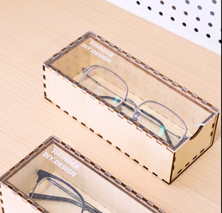

Step 6: Assemble the Box
Arrange the cut pieces according to your design. Apply wood glue (for plywood/MDF) or acrylic adhesive (for acrylic) to the joints when necessary. Carefully align and press the pieces together, making sure the corners are square. Hold or clamp the box until the adhesive sets.
Put the wood pieces together
Step 7: Complete the Laser Task
Once the glue is fully dry, your glasses box is ready to use. You can leave it minimalistic, or add finishing touches such as varnish, paint, or even personalized laser engravings on the surface for decoration.
A laser cut glasses case
