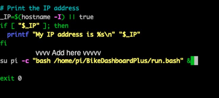

2. Make a backup of "/etc/rc.local":
sudo cp /etc/rc.local /etc/rc_backup.local
3. Edit "/etc/rc.local":
- Type "sudo nano /etc/rc.local"
- Scroll down. Type in 'su pi -c "bash /path/to/BikeDashboardPlus/run.bash" &' before the "exit 0". You can see what the path is by typing "cat ~/BikeDashboardPlus.txt". Make sure to add the ampersand or the Pi will not boot. This line will make the Raspberry Pi run the program when it boots. The "su pi -c" runs the program as the "pi" user so you can access the files in the program later.
- Save and exit: Press ^X (Control-X), then Y, then enter.
4. Reboot the pi: "sudo reboot"
From now on, the program should run after you boot up your Raspberry Pi.

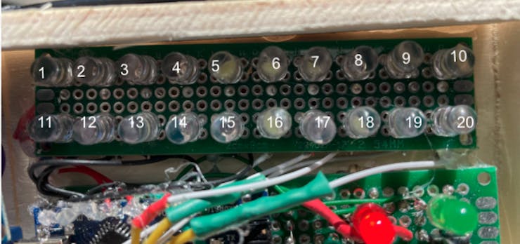

This is how the LEDs on the LED panel are numbered:
How it works: If the configuration “LED” is 0, then LED n (on the panel) will light up if you are going n mph, km/h, or m/s. If “LED” is set to 1, then LED n/2 will light up if you are going n mph, km/h, or m/s.

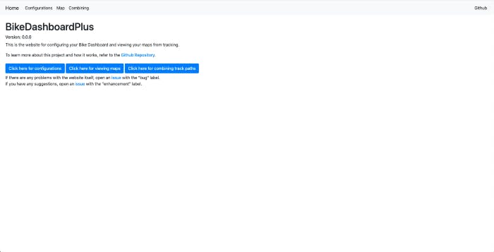

Go to the website shown on the OLED. It should be "http://{your.pi.IP}:7123".
On the home page, you should see this (the version number will be different):
There are 3 options: the configuration page, the map page, and the combining page. I will go through what each one does.
Configuration
The configuration page should look like this:
It is a table showing all the configurations, what they mean, and what value you have to enter. You have to enter that value into the text box on the right column of the table.
For the time zone, you should copy and paste from the list in the link rather than typing it out as you have to type it out exactly like it is in the table.
At the end, click submit.
