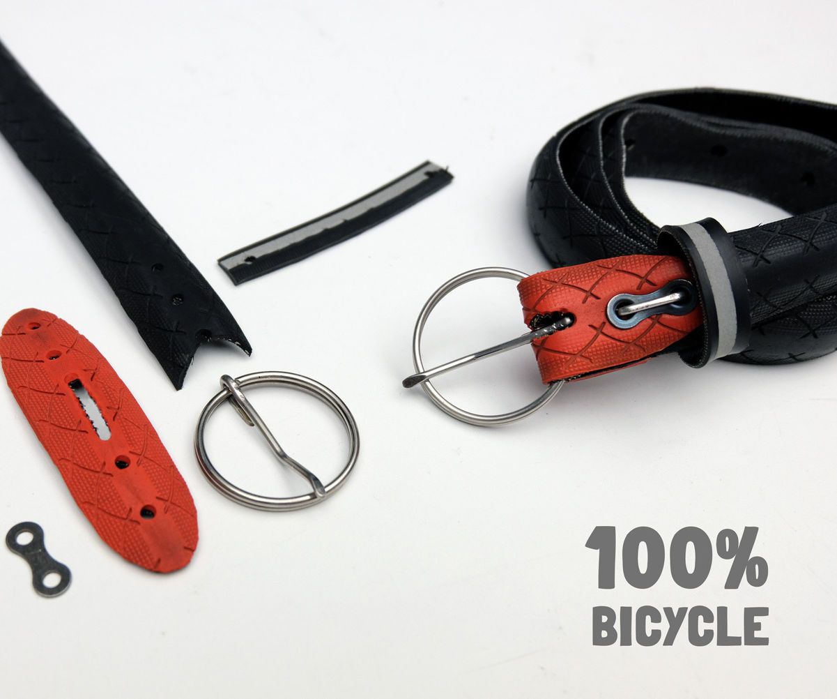

The Spoke Bender is a tool for winding bicycle spokes into round coils.
It was originally designed for the production of upcycled belt buckles, as part of my 100% Bicycle Belt project (How to Make a 100% Bicycle Belt). However, I'm also experimenting with other applications for these round coils, such as key rings and curtain hooks. If you come up with other possible uses you are welcome to share them with the community!
In this tutorial I will show you how to produce the tool out of scrap materials and hardware products. Due to Covid-19 I could not take process-pictures, so I'm working on the editing of some illustrated instructions that will very soon be added to this tutorial.
