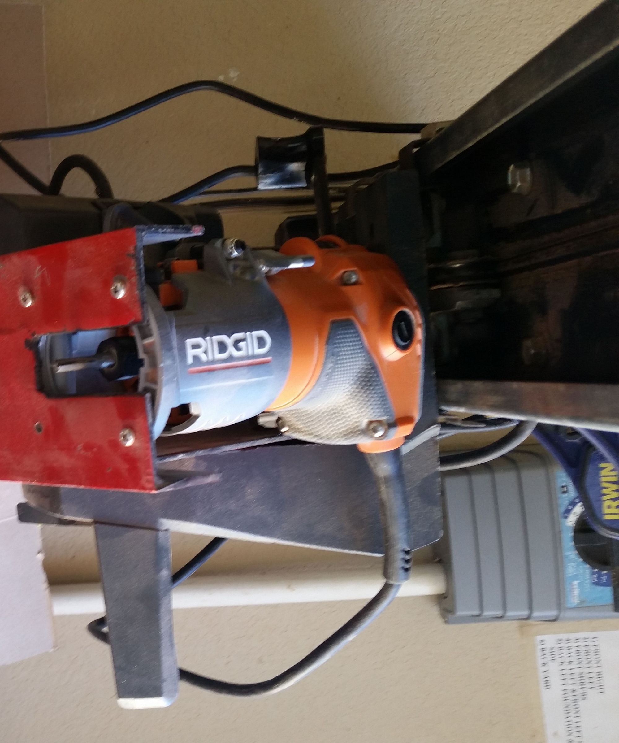

When I cut the base for a project I've been working, i made a mistake and did not finalize the outer ring. I knew I could do it later, but had never attempted something so large. The good thing is this technique will work large and small. In this, its the method you want to learn. It doesn't depend on the tools.
When i went back to finalize the outer size, i did not have a fixed inner radial point to spin from. I still had the cut disc so i shimmed it back in, and mounted my circle cutter as featured in one of my previous projects.
I knew the shimmed piece wasn't stable enough to spin the spiral cut on. Besides i didn't want to push the spiral cut thru 1.25" of plywood thru 70 some odd inchs of wood in a single pass.

Using the my circle cutter, i just ran a pencil line around from a hole.
For those paying attention to the picture. You'll notice I took one of the screws out so i can get a max circle of 23.75 inches in that configuration.

For this part, like in the circle cutter i used my sander. I mounted the piece on the bearing my RAS and attached my large sanding drum. I spun the rough disc on the bearing against the RAS Sander and worked it all in till i could not feel a difference around the perimeter of the circle nor could get a sound when the sander was spinning telling me it was true. Later, i pulled the motor up to 45 deg and sanded a little round over on the bottom to reduce splinters.
