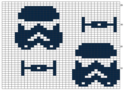

This tutorial is for 2 crochet hat patterns - a his & hers version of the hat. The materials and techniques are the same for both patterns with a few variations in her version. In her version, you will be skipping the TIE fighter between the two Stormtroopers, the space between the two Stormtroopers is 14sts, instead of 22sts, and the edge of the hat has a ribbing. The instructions for the pattern come with a pixel chart for each version. Enjoy!

Step 1: His Force Awakens Version
Please note: the white squares represent colour A, and the blue squares represent colour B. Each box represents 1sc st.
To begin, ch111 using colour A, join in the round with a sl st.
Rnd1: continuing with colour A, work sc in the back loop only (rib stitch) until you reach the last st, ch1.
Pattern begins, read the chart from right to left
Rnd 2 – 18: Using sc in the back loop only, repeat the pattern for a total of 3 times. That means you will have a total of 3 Stromtroopers, and 3 TIE Fighters.
Rnd 19: Continue working in pattern while at the same time beginning a repeat of Rnds 2-18. Continue working in pattern for a total of 39 ends.

Step 2: Her Force Awakens Version
To begin, ch87, join in the round with a sl st.
Rnd 2 – 21: Using sc in the back loop only, repeat the pattern for a total of 3 times.
