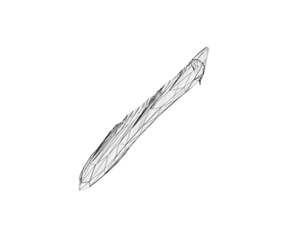

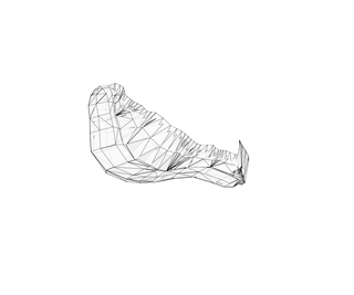

On the left hand of the screen is a tool bar. Click the browse community button to download a model created by someone on 123d Make or push the import button to load a model of your own. Attached are two .STL files from my angel statue design to test the program immediately.

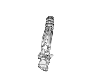

When the STL file imports it will look similar to what is shown below.
If the model needs rotated slightly there is a button in the program to do that though the rotation moves in increments of 90 degrees so fine tuning should be done in the design program.
The next step is to choose the technique to cut the model out. For my statue I choose stacked slices as it gave the effect I wanted and maintained a lot of detail however you should experiment with the other modes for a different effect. More information can be found on the 123D make website.
