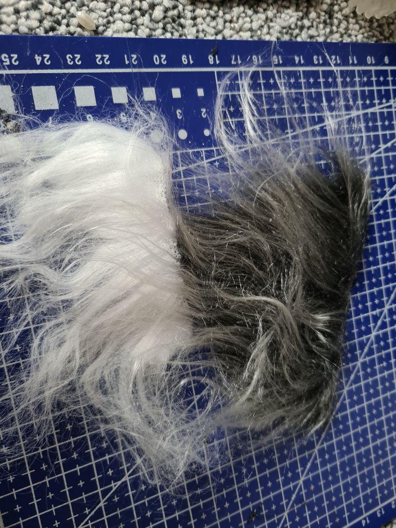

I am a very creative person but I can not draw to save my life. I had a few attempts at drawing on a face and they were all hideous. Safe to say drawing is not my thing. To get around not being able to draw the face, I decided to try and cover most of the face with accessories. I used some Mongolian fur to make him a moustache and beard.
For the beard, I cut a small triangle using an Exacto knife. Turn the fur over and cut the back lining only, this will prevent you from getting the straight cut in the fur.
Step 10: Shape the Fur
You can use a comb to part the beard and the moustache. Mine was a bit too bushy so I gave it a trim and used hairspray to hold the style in place.

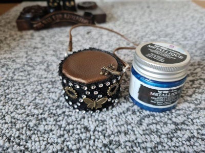

If you want the drum you can add some match sticks with beads on the ends as drumsticks. To make the drum, I repurposed a small paint tub and covered it with felt. I used some rhinestone wrap which I cut and glued to the drum. You can use some leather laces for the strap for the drum. Lastly, to decorate the base I used some stamperia moulds and resin to make the sign and embellishments.

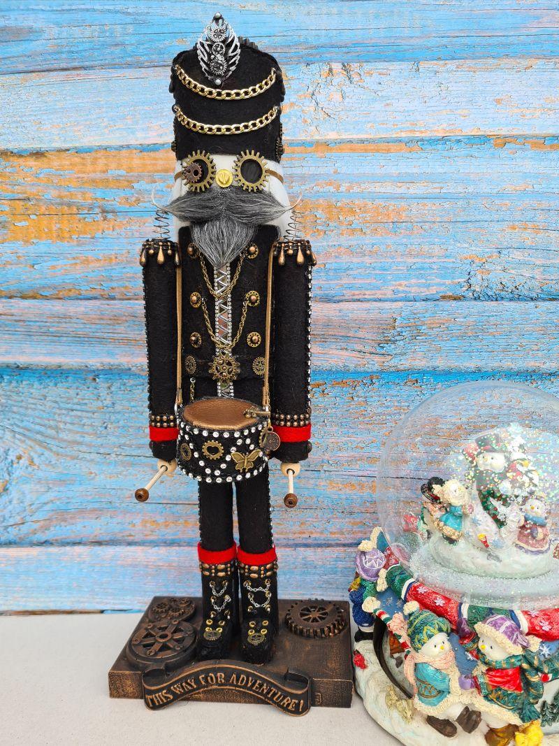

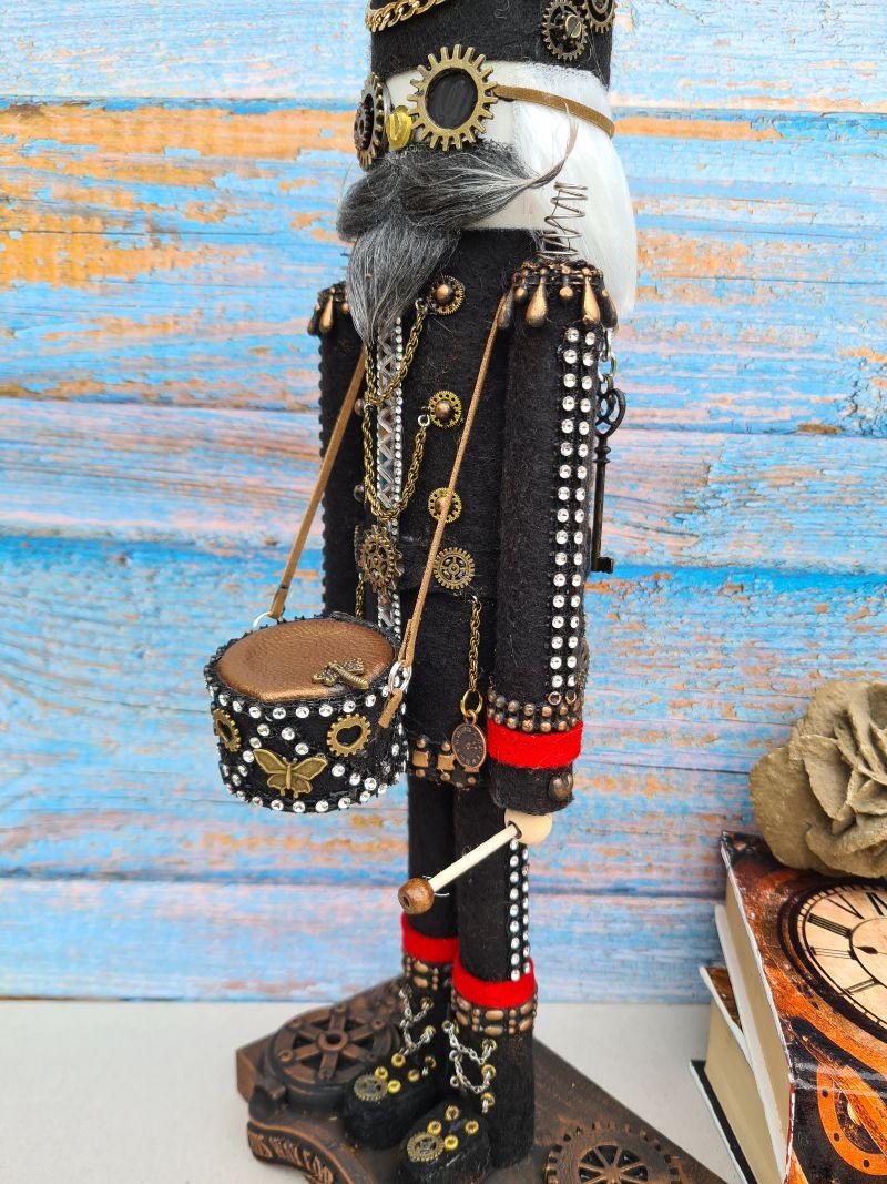

Step 14: Finished Steampunk Nutcracker
I hope you enjoyed seeing how my steampunk nutcracker was made, here are some more images so you can see all the details.
