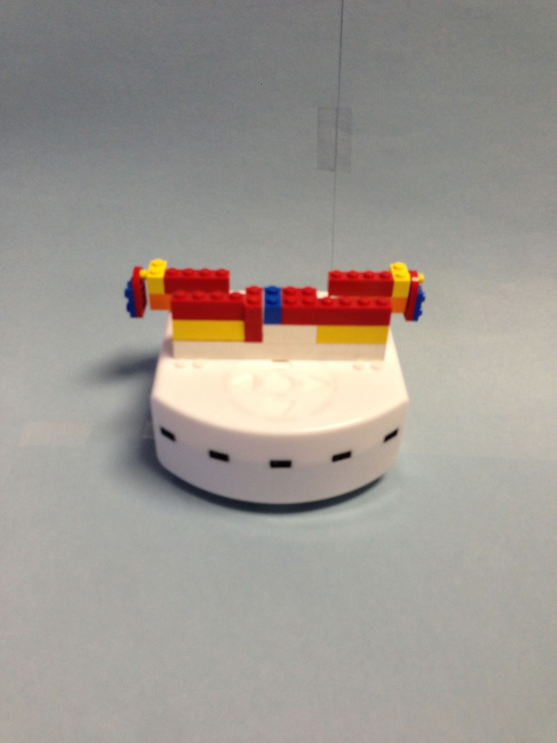

Step 6: Assemble the Upper Gear System
Start off by finding two flat 2 x 8 gray Lego piece, two 1 x 14 gray pieces with holes going through the middle, and two 1 x 2 gray pieces. Put them together as shown above and install onto the Thymio.
Step 7: Assemble the Front Wheel
Start off by collecting four 1 x 12 gray pieces with holes, two 2 x 8 flat gray pieces, one black axle, two yellow technic studs and a large wheel. Assemble as shown below.
Step 8:
Attach to the Upper Wheel Gear as shown above. Then add a 1 x 14 gray piece to support the connection.
Step 9: Assembling the Upper Wheel
Take a yellow technic stud, a gray technic stud, a gray gear, a black axle, and a large wheel. Assemble as shown below to make the upper wheel. Repeat these steps one more time to form the other wheel.
Step 10: Attach Both Upper Wheels
Take two more of the yellow technic studs to attach the wheels as shown above. Double check the connection and you have finished the assembly of the Super Charged Thymio.
