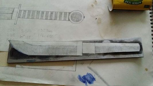

Step 1: Making the Template.
So using Geometry i make this design 30mm thick blade (about 5 3/4" Blade) then measure in for the 1/8" Ha-Machi & Mune-Machi (front notch & back notch in English) then measure a line out straight about 30mm or so for the Habaki (Collar) then taper the Tang, all simple to do, if you're struggling to get the concept just look at a Japanese Tanto Bare Blade you will catch on in no time.
Step 2: Marking the Steel
So the template will be cut out now? Fantastic, so you need to keep the template for reference all throughout the build, so let's start by drawing it onto the steel, proposing you have bare steel and it all true and clean, if not, drop back and step, grind, file, sand the mill scale off down to bare steel and draw the template on.
