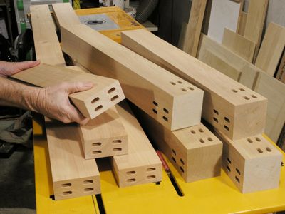

Mortise and tenon is the traditional choice for rail to leg constructions. Without a hollow chisel mortiser or the desire to handcut these joints I opted to use a domino tool and make the frame with loose tenon joints. There are other ways to effect loose tenons, however the domino tool proved highly effective as it took me only an hour to cut the 64 mortises required.

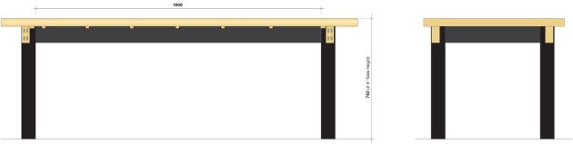

Most table rails are around 90 x 25mm in size. To achieve adequate strength using domino joints I increased the rail thickness to 50mm so four dominos could be used for each joint. This also increased the gluing surface to further strengthen a frame that now supports a 2250mm long top. The tenons need to be spaced at least 20mm and 10mm apart. The legs are 90 x 90mm with 3mm corner radii and the aprons are 4mm offset from the outer face of the legs.

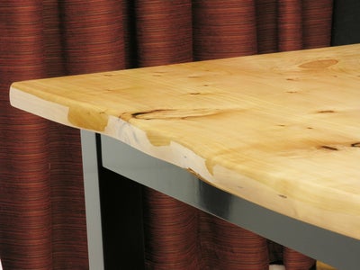

The macrocarpa slab needed to have the bark removed and the edge cleaned up. Local Titirangi carver Kim Carati crafted a smooth and sculptural edge.

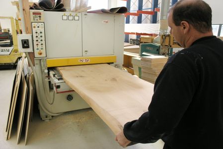

I’m no expert with winding sticks and a smoothing plane and I definitely didn’t want the platter rocking as the Christams turkey was carved, so it was off to a nearby cabinetmaker who put the slab through his Powermax thicknesser two or three times.
Fortunately the rough sawn slab was not warped or twisted which made this easy. This machine has a spiral cutterhead followed by two oscillating sanding drums that finished the slab to 180 grit. Back in the workshop I ran over the surface with my random orbital sander at 240 grit.

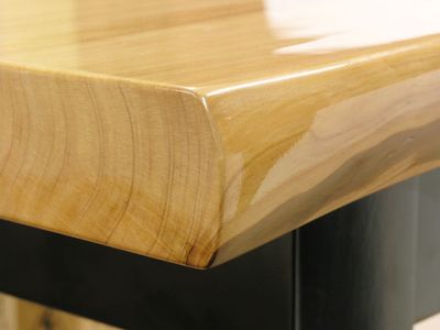

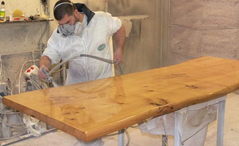

A dining table needs a durable finish and I also wanted a glossy look which I was not confident of producing. And so I was off again, this time to the local furniture spray finishing service that has controlled environments for spraying and drying finishes to ensure an even, mirror finish.

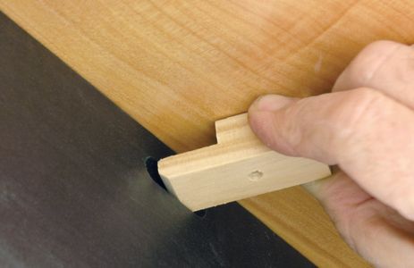

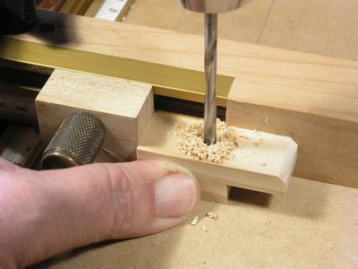

Sixteen custom made buttons secured the top to slots cut into the base aprons, positioned to allow movement.
Cutting List
Top 2250 x 900 x 50
Legs 4@ 712 x 90 x 90
Rails 2@ 1800 x 105 x 50, 2@ 520 x 105 x 90
