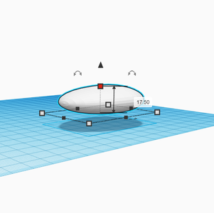

Step 1: Step 1: Making the Racket Head (Part of Frame)
1)
- Drag an egg from the 'character' panel (the default size is perfect)
- Reduce the height to 17.5
