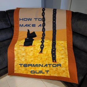

Introduction: How to Make a Terminator 2 Inspired Quilt
A while ago I made a Mandalorian inspired Quilt and I love it so much. I ended up hand sewing the applique pieces onto the background of the quilt, and it took about 2 months, working on and off.
My newest quilt is Terminator 2 themed, and with all the kinks worked out of my quilt creating method the process was much much quicker, as it was completed entirely on a sewing machine.
I completed the Terminator Quilt in about a week, spending roughly 3 hours a day working on it.

Step 9: Admire Your Finished Quilt
I am loving the way the Terminator Quilt turned out (and how fast the process was this time).
The only limit to quilting is your imagination, and you can find plenty of inspiration to be found on Pinterest and online.
I can't wait to start thinking about my next project.
Thankyou to Instructables for hosting such great contests.
I hope you love this as much as I do!
