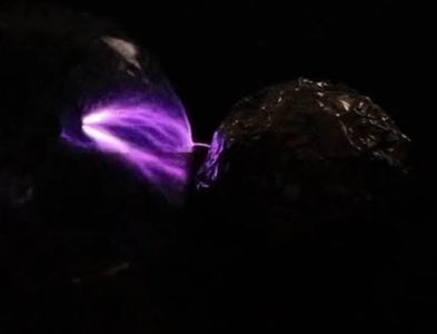

Step 8: Checking Everything and Done
  • We are done but there's a one thing which is left the copper wire which we have left at the end we have to attach that with a bulb and then the magic begins .
CONGRATS !!! WE HAVE MADE IT !!
Step 9: Ending Words
Believe me guys it is so easy to make and works same as a high voltage tesla coil the results turned pretty good you can watch in the videos which I have shared also if you want more power you can use a high volt battery or a high voltage step up transformer.
