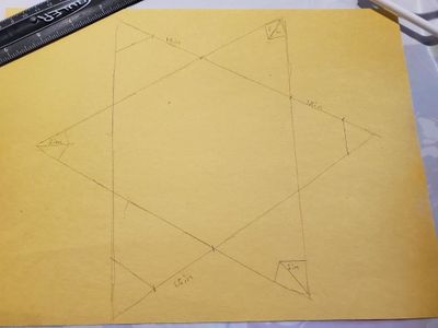

Step 4: Making a Template
Once you have all 16 pyramids, take one of those pyramids and a sheet of construction paper and trace a triangle , turn the triangle to where the corners are in the middle of the sides, trace this too. Once you have the basic shape, mark off the area of 3 corners that wont be covered and folded, then mark where it folds on the other sides.Cut out the basic shape and then cut out the basic shape in the fabric. Then cut the details into the template, cut out the marked areas and one of the corners without the markings will be cut off.

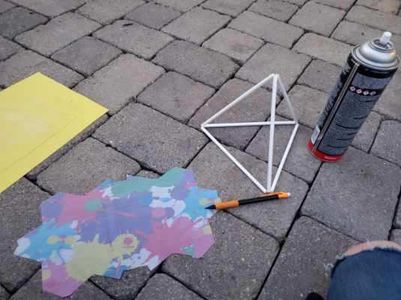

Step 5: Cutting the Fabric
Take the template you just made and place it on the fabric you have chosen to use, trace it onto the fabric and flip it but keep the flat side on the line you already traced from it, then cut it out to get the shape as shown.
Step 6: Gluing the Fabric
Place the pyramid onto the fabric the way you made the template or how it is in the picture, first spray or apply glue onto the middle line and place your pyramid on top. Then put glue on the two flaps and fold them over so they will stick, turn the pyramid over and repeat the process to get one pyramid with two sides covered. Repeat this for all 16 pyramids, not all sides of the pyramid will be covered.
