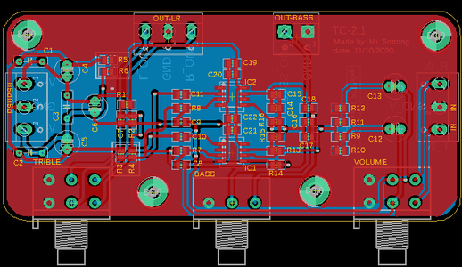

Step 2: Schematic and Layout
You can see the schematic and layout in the image above.
I have divided the schematic into several parts according to their respective functions. So it's easy to read and learn.
My PCB design uses 2 layers to make layout easier and save space. Since my PCB is dual layer, there is no way I can make it myself at home. For that, I made my PCB on PCBway.
For this schematic and layout, I design using the eagle application. For the original file, you can download it below.
Step 3: Make PCB Fabrication
Because my equipment is not yet qualified to make double layer PCB. PCB I made on PCBway. why did I choose PCBway, because By making PCB on PCBway you can get High Quality 10 PCs PCBs for only $ 5 & new member First order Free: www.pcbway.com .
For the finished PCB, you can see in the picture above.
To print on PCBway, PCB design needs to be converted into gerber format.
You can download the gerber file below, I provide it for those of you who want to make it too.

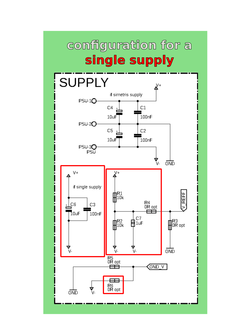

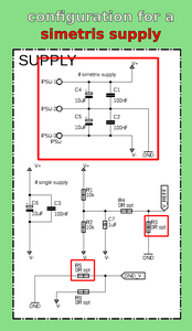

Step 4: Power Supply Configuration
This tone control can use a single power supply and a symmetrical power supply.
You can see the configuration for these two conditions in the image above.
the components in the red box are components that must be installed in each of the selected configurations.
