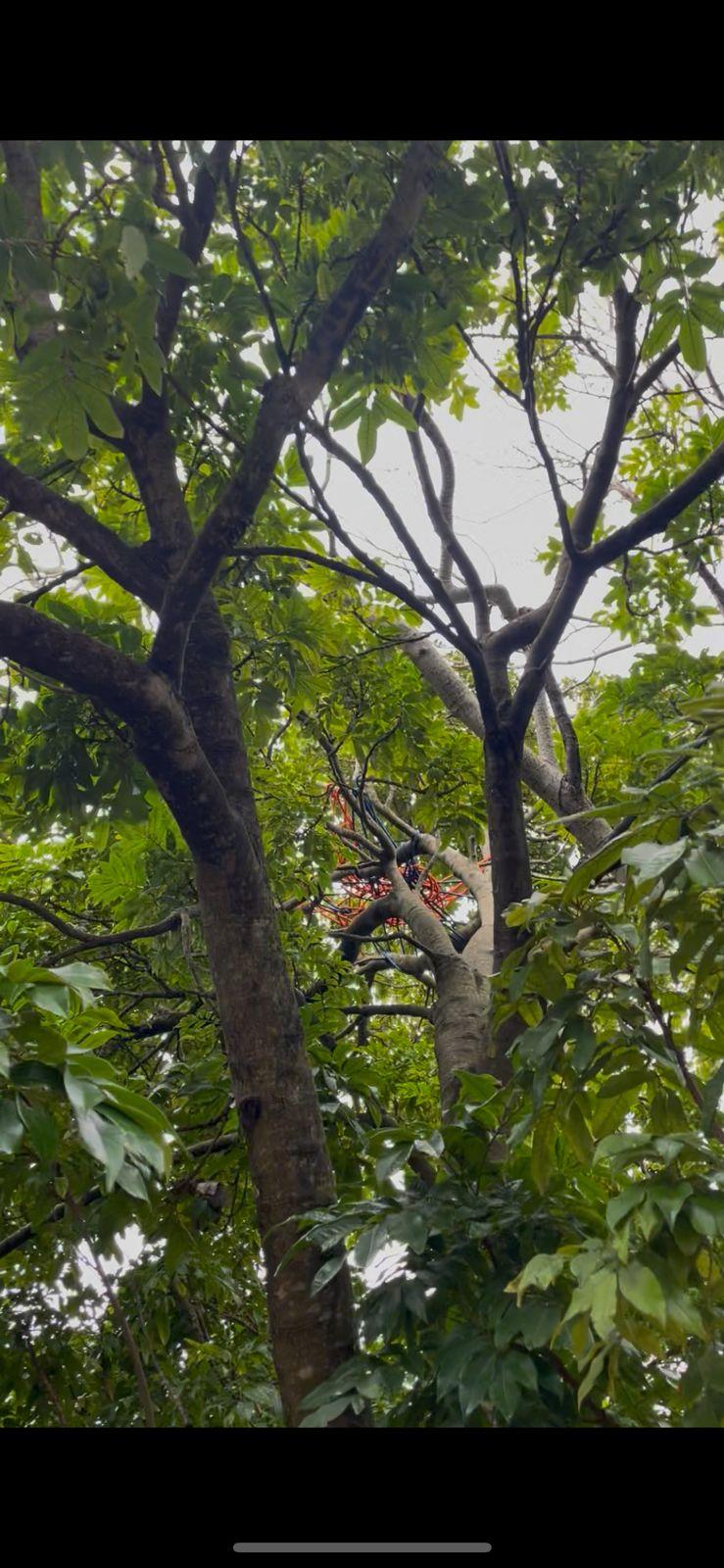

Step 2: Find a Tree
Now that you have your rope, you need to go find a good spot in a tree to make it. I would suggest building it in a tree a few meters off of the ground, preferably in a spot with a good view. It goes without saying but remember that the higher you build it the more dangerous it is. You should also build it in a tree that has enough branches for you to easily climb up to your tree net. That means that palm trees are not recommended.
Make sure that the branches that you are going to make your tree net in are alive and healthy and that the main branches that are supporting most of your weight are about 10 centimeters in diameter. It is also important that there are more than enough branches as the quote “less is more” does not apply here. If a branch does not look like it can support your weight, don't use it!

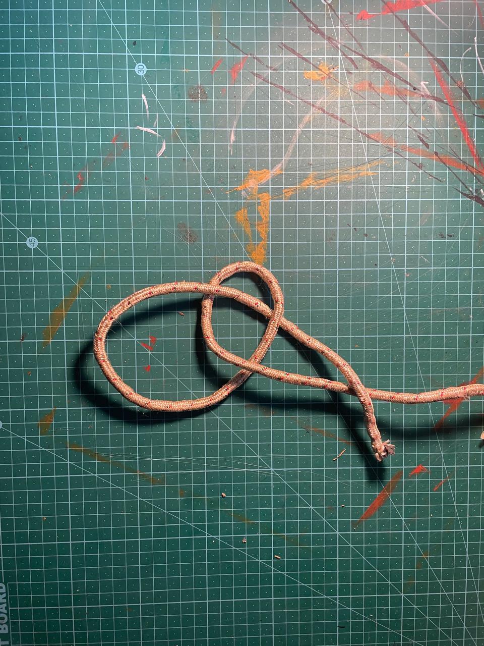

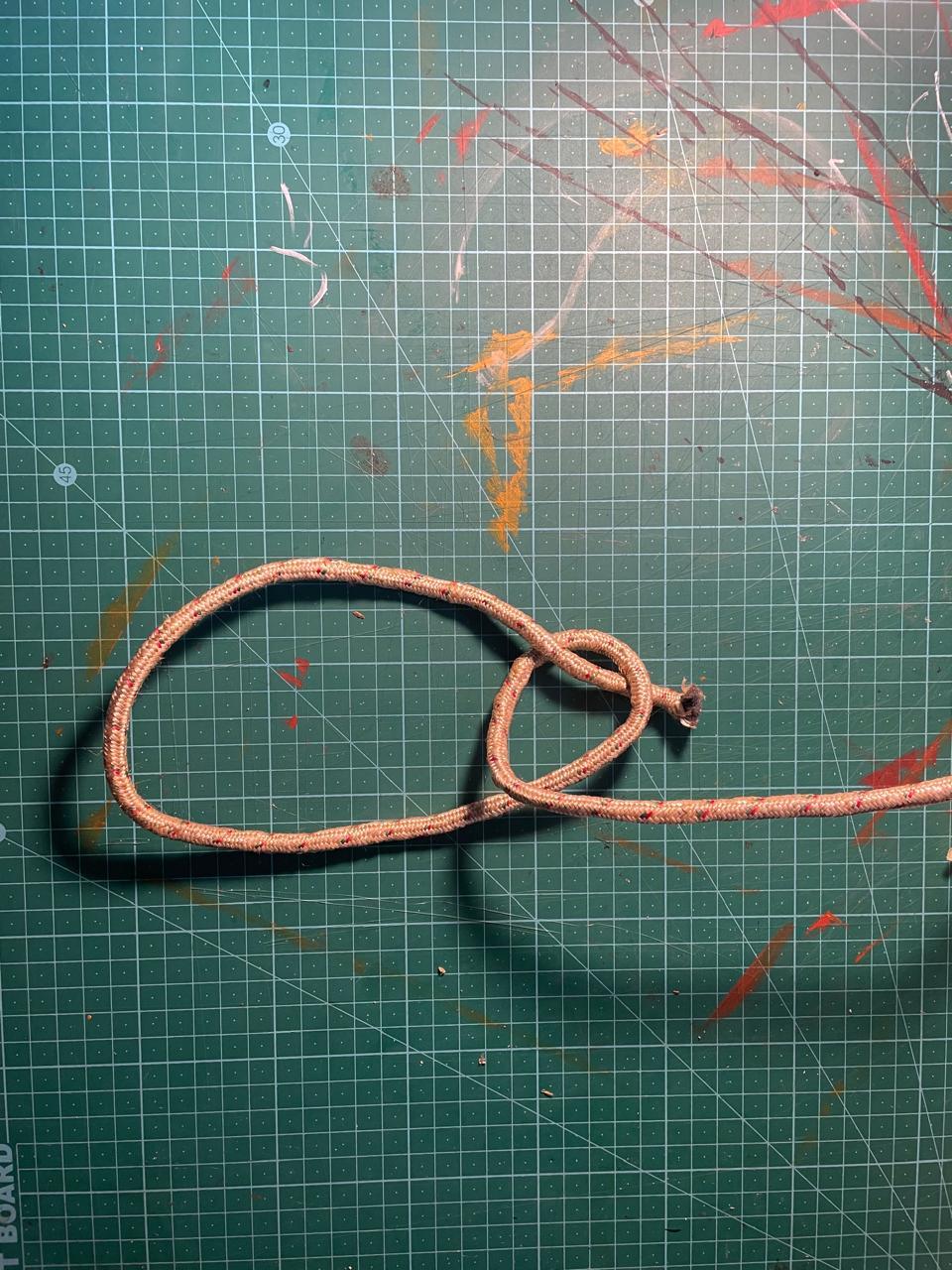

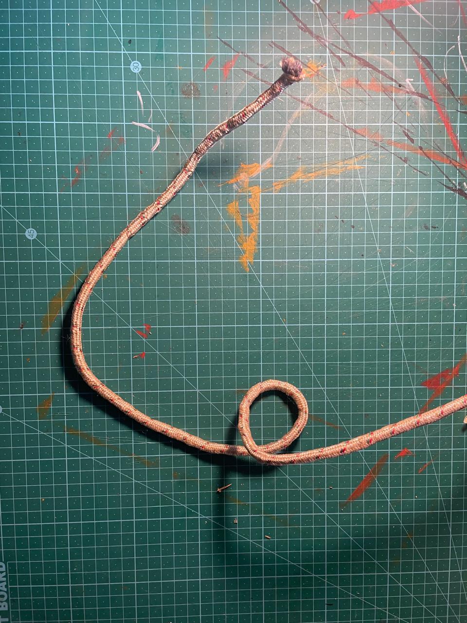

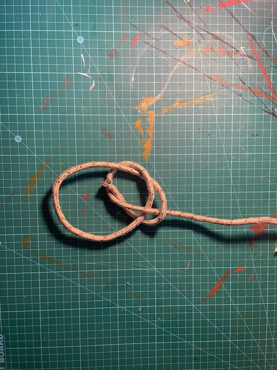

Step 4: Start With a Bowline Knot
Bowline knots are strong and won't unravel if you tie them correctly. They are also easy to remove if you ever want to move or take down the net. Refer to the photos to see how to tie a bowline knot, or this video.

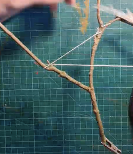

Step 5: Make the Framework
Make the main structure of the tree net first. The fewer branches you are using the more framework you will need to make as you need either rope or branches to make the interior of the net on. Think of the framework as the foundation.
Remember to keep everything tight at all times. If the net gets loose it could be dangerous and you would have to redo it.

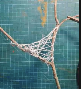

Step 6: Weave
Weave the rest of the rope between the branches and the rope you put in as framework. go over and under the rope that you have already put in to keep everything tight.
Try to think of the tree net as a horizontal spiderweb. There are supposed to be no big holes or knots anywhere on the net. Once you have made enough then you can sit on it to make the rest more quickly.
