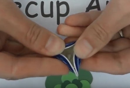

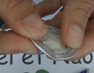

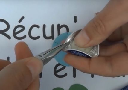

Draw around your capsule. Cut out the circle. Fold the circle in 6 and mark this 6 lines. Use this circle to divede the coffee pod in 3 afterwards. Use a flat nose plier to fold the coffee pod, where you have marked. Than with your fingers fold the sides completely inward.

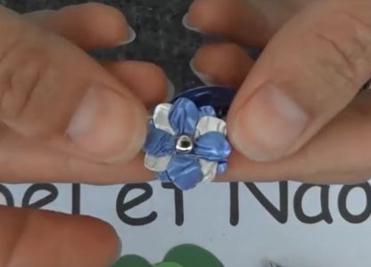

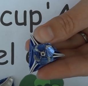

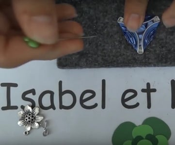

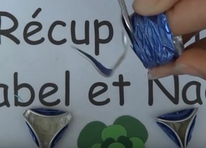

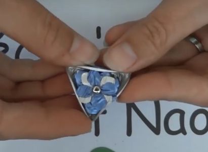

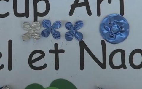

Crush a coffee pod entirely and open in up again. Cut of the bottom and the top. Flatten a bit and you have a nice embossed texture. Use this to cut out your flowers of choice. Now perforate the flowers in the middle as well as the top of a coffee pod. Add a brad to the middle and arrange the petals as you like. Add the prepared flower to the triangle and close. Add a bail and your pendant is done.

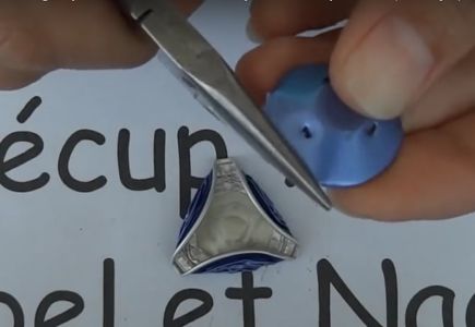

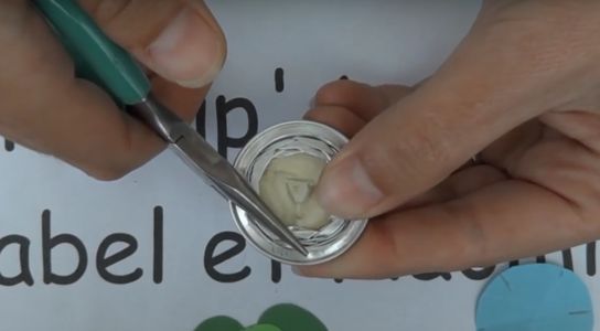

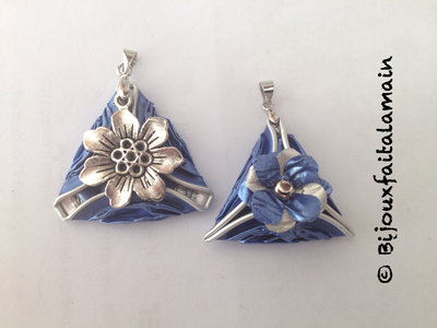

Use the same cut out paper circle to mark your coffee pod. The difference is, where you mark your capsule, you press with your flat nosed plier as well. Hereafter you fold with the plier as well. Use another top of a capsule to fill the middle and choose a decoration of your liking for the middle. Finish the pendant by attaching a bail. Et voilà you have two different triangle pendants. We hope you like the instructable!!
