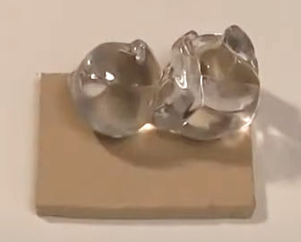

The goal of this step is to create a place holder for the bottom half of the mold out of clay. This way, you can pour the Mold-Star silicone on top of the clay and the model, creating the top half of the mold.

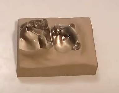

  1. Start with a block of non-hardening clay, and create a cavity in the block to fit your model.
  2. Build up the clay around the model to where you want the seam of your mold to be. The seam is normally halfway up the model.
  3. Ensure the clay is as smooth as shown in the picture. If the clay base ends up with irregular bumps, it produces mold halves that are difficult to de-mold.

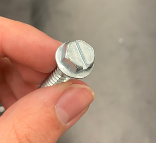

Step 2: Add Keys to the Base
  1. Use a bolt or nut to add impressions into the clay base. This helps both parts of the mold to come together in the right orientation. Keep in mind that the more textured the key is and the more there are, the more difficult the de-molding process will be.

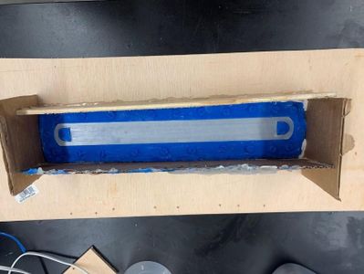

Step 3: Build the Mold Box
  1. Hot glue four pieces of cardboard together around the base, and further seal each edge with hot glue. This ensures that no silicon seeps through.

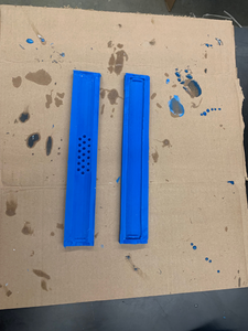

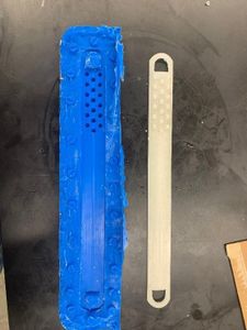

Step 5: Remove the Top Half of the Mold
  1. After the mold is cured, remove the mold box from around the mold and set aside the cardboard for now.
  2. Carefully peel the clay from the model and mold. Do not remove the model from the top half of the mold.

  1. Rebuild the mold box around the top half of the mold, with the impressions in your new mold facing up.
  2. Fill any abnormal caps with extra clay to limit leakage. Keep a hot glue gun ready to fill any seams that may leak silicone.
  3. Spray mold release onto everything again and let sit for 5 minutes.
  4. Pour the silicone mixture into the mold box as done with the top half of the mold.
  5. Allow everything to cure for another 6 hours.
