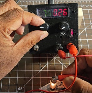

I had an adjustable PSU module with built in digital meters for voltage and current with a constant voltage and current feature. The module provided from 1-25V with up to 2A of current. This module is a few years old and not as nice as the new LCD power modules but it was what I had.
A quick test fit of the components and some of the wiring indicated that the wires going to the input and output screw terminals of the variable PSU board did not let the board fit into its case. So decided to solder the input and outputs directly to the board rather than using the screw terminals (not shown).
The modules were attached to the top as shown in the photos. The two potentiometers are under the PSU module. A small piece of acrylic was glued in as a light pipe to show the status of the LEDs on the PSU module.
I used a scrap piece of aluminum as a jury rigged heatsink for the PSU IC. The heat sink was glued with thermal epoxy plus some sponge pads that you can just see.
The USB-C decoy board was attached to the base and the output of this board was wired to the input of the upconverter. The positive output of the upconverter was wired to the power switch and the negative output of the upconverter was wired directly to the adjustable PSU module.

I connected the outputs to a multimeter to check voltage accuracy. The readouts were within 1-2 percent with most of the variation seen at the low end, below about 2.5V.
A 12V incandescent bulb was connected to check the constant current mode. The LED changes from green to red when in constant current.
The small variable power supply is turning out to be extremely useful due to its small size, clear readouts and the ability to use the USB-C laptop power source that is already plugged in at my bench.
