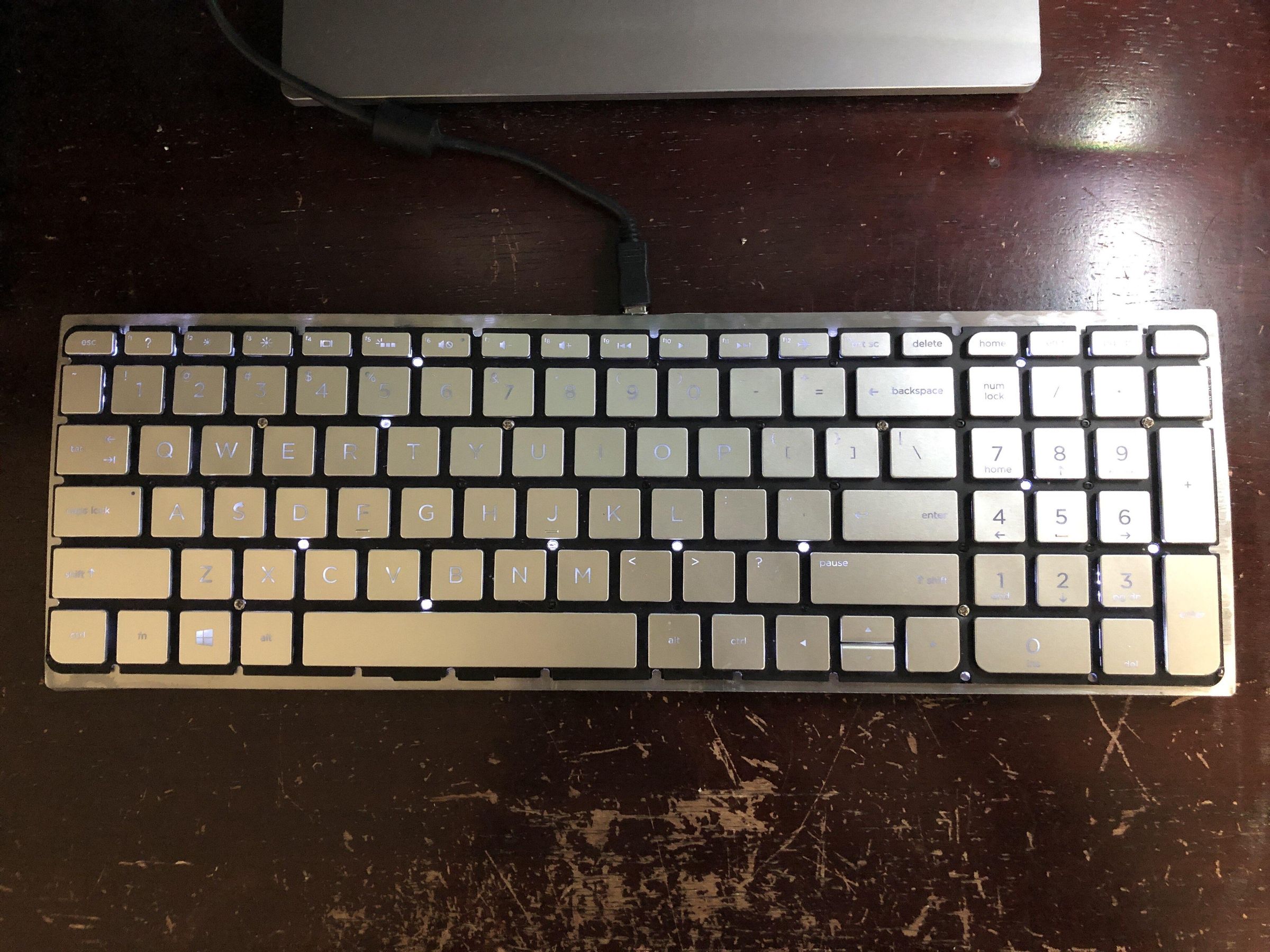

Introduction: How to Make a USB Laptop Keyboard Controller
This Instructable will provide a step by step procedure for building a USB laptop keyboard and touchpad controller. I created this guide and video to hopefully make it easier for people to re-purpose an old laptop. A typical laptop keyboard relies on the motherboard for the keyboard scanning and touchpad interface. I use a Teensy microcontroller mounted on a connector board to take over this function. Teensies are often used by the mechanical keyboard enthusiasts at Geekhack and Deskthority and the TMK or QMK software is the most popular controller code. The TMK/QMK code is a bit of an overkill if you just want a simple USB keyboard but it will certainly provide all the features you could ever need. If you would rather write your own keyboard software using Arduino, the Teensyduino functions give you total USB control. Whatever software you decide to use, it will require a key matrix that maps out how your keyboard is wired. One approach, (that I never want to do again) is to exhaustively check every connector pin combination with an ohm meter while holding down each key. I did this when I converted a Sony Vaio into a Raspberry Pi laptop. An Instructable from alpinedelta disassembles the keyboard in order for the connections to each switch to be visually traced back to the connector. Instead of taking the keyboard apart or using an ohm meter, this Instructable will load the Teensy with an automated continuity tester. The Teensy will report over USB, the two pin numbers that are connected when you press a key. After every key has been pressed, the results can be transferred to a row-column matrix and used by the TMK/QMK keyboard controller software or a home-brew Teensyduino routine. The touchpad code described in step 22 can be added to the keyboard routine to create a composite USB device.

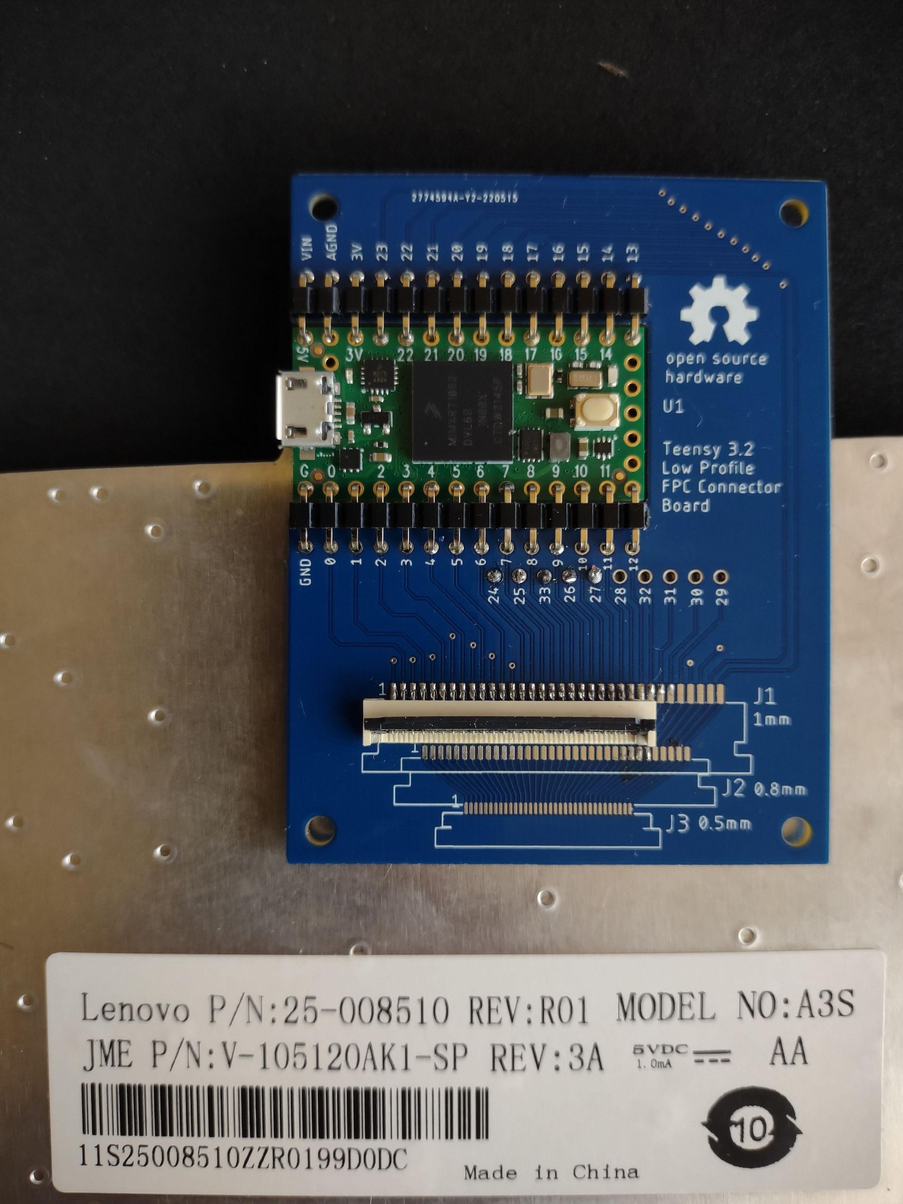

Step 3: Teensy LC FPC Connector Assembly - Surface Mount or Thru-Hole
I designed a circuit board using Eagle for the Teensy LC that routes its 26 I/O pins to 26 surface mount pads for an FPC connector with a 1mm pitch or a 0.8mm pitch. I created a second circuit board for keyboards that have a 0.5mm pitch. For those that don't want to solder surface mount connectors, I created the board shown on the right for thru-hole FPC connectors. A connector with up to 26 pins can be soldered to these boards based on your needs. For connectors with less than 26 pins, solder starting at pin 1 and leave the unused pads at the other end blank. I avoided using the 27th Teensy LC output because it’s connected to an LED and 27 pin FPC connectors are rare.
After soldering the FPC connector to the board, I soldered 4 header posts to the board to support the corners of the Teensy and then I soldered the Teensy to the header posts. The last step was to connect the rest of the Teensy I/O signals to the board with 30 gauge wire. I used wire instead of header posts to make it easy to reroute I/O pins or cut the Teensy off the board. If you buy a Teensy LC with pins, it will not have pins on I/O's 24, 25, and 26 so you'll need to add them.
Step 4: Teensy 3.2 or 4.0 FPC Connector Assembly
I designed the back side of the board for a Teensy 3.2 with 34 I/O signals and an FPC connector with a 1 mm or 0.8 mm pitch. A different 3.2 circuit board is available if you have a 0.5mm pitch.
Whichever side of the board you mount the Teensy on, you must solder the FPC connector on the same side.

I created a new circuit board for the Teensy 4.0 that routes its 34 I/O signals to pads for an FPC connector with a 1 mm or 0.8 mm pitch (see pictures above).
If your keyboard uses FPC pin 34, you must disconnect the LED near I/O 13 on the Teensy 3.2 or 4.0 in order to avoid interfering with the keyboard scan. I find it easier to unsolder the current limit resistor right next to the LED instead of unsoldering the LED itself.
Solder the FPC connector to the 3.2/4.0 side of the board and then proceed to the next step.

Step 7: Low Profile Connector Board - Teensy LC, 3.2, & 4.0
A Teensy with header pins that is mounted on an FPC connector board may be too tall to fit in a thin laptop case so I designed the board shown above. The Eagle board file, "Teensy3p2Cutout.brd" can be downloaded from my repo. A Teensy 3.2 (as well as an LC or 4.0) will fit in the cutout and U shaped header pins on each side will hold the Teensy in place. These pins will tie Teensy I/O numbers 0 thru 23 to the connector board. Teensy I/O numbers 24 thru 33 are on backside SMD pads and must be connected with jumper wires. I used "U" shaped header pins from Ali Express that have a width of 6mm (even though their documentation shows a 5mm width). The board will work with 1mm, 0.8mm, or 0.5mm pitch FPC connectors with up to 34 pins. The Eagle file "Teensy3p2CutoutFlip.brd" rotates the Teensy 180 degrees so it can fit in a cutout on the right side instead of the left (see picture above). Use this board if the USB connection is on the right side of the laptop base. The left cutout and right cutout boards route the I/O signals the same as the Keyboard_Scanner_LT2 connector board and will use the same Teensy 3.2 software. If you would rather use a Teensy 4.0, it will also fit in the board cutout. If you wire the backside I/O numbers 24 thru 33 per the silkscreen labeling, you can use the Teensy 3.2 matrix decoder software to get the correct translation. The Teensy LC can also be used in this manner with jumpers for I/O numbers 24 thru 26.

Connect a USB cable from the Teensy to the computer and wait 20 seconds for the Teensy to be recognized as a USB keyboard. This delay is in the code to make sure your computer is ready to receive numbers from the Teensy. If numbers are reported on the screen before any keys are pressed, these pins are shorted together and must be fixed. It may be a solder short on the connector which you can check by retrying without the keyboard connected. If it is still shorted without the keyboard, use flux and solder wick on the shorted connector pads. If the short goes away when the keyboard is removed, these pins are most likely ground pins that are tied together in the keyboard and must be excluded from the routine. Adjust the max_pin or min_pin values in the code to allow the routine to skip over these pins. Another reason to reduce the max_pin value is because some of the FPC traces may be visibly tied together as shown in the picture above. The original motherboard controller used these shorted pins to identify the language of the keyboard but the Teensy code will report the short and then hang.
If your keyboard has shorted pins that are in the middle, adjusting max_pin or min_pin will not fix the problem. In that case load the Matrix_Decoder_LC_alternate, Matrix_Decoder_3p2_alternate, or Matrix_Decoder_4p0_alternate routine. These routines allow you to exclude any pins necessary to avoid shorts.
If you are using a Teensy ++2.0 and you get the numbers 1 and 15 reported on your screen, you forgot to unsolder the LED located on the Teensy. The Teensy 3.2 and 4.0 will report 1 and 34 as shorted if you are scanning a 34 pin keyboard cable and the LED has not been removed from the Teensy.
If certain keyboard keys do not give a response when pressed, it is usually caused by a bad solder connection, tarnished cable, or misaligned contacts. To prove the code will report all possible pin connections, use a small flat screwdriver to momentarily short pads 1 and 2 at the FPC connector, right on top of your solder joint. Move on to pads 2 and 3, 3 and 4....., proceeding up to the last two pads, taking note of any pad numbers that don't work. For the pads that don't give a response, reheat the solder joint on the FPC connector pad and if necessary, at the header pin on the Teensy. For the Teensy LC, don't forget to add header pins on I/O's 24, 25, and 26. Use the pin translation table in step 14 to map the FPC pin number to the I/O number on the Teensy. Keep fixing your solder joints until you get a response for every pin when you short them with a screw driver. If some keyboard keys are still not working, there may be a bad connection to the FPC cable. Gently clean the FPC cable with an eraser if the metal traces look tarnished. Use a magnifying glass to inspect inside the FPC connector to see if the contact points are in alignment with the cable traces. You may need to trim the side of the FPC cable to get the proper alignment. If alignment looks good, push down on the FPC connector or lift up on the cable while trying the bad keys to see if you can sometimes make them work. You may need to add a thin piece of paper or tape to the plastic backing on the FPC cable to get a tighter fit. Erratic keys can sometimes be fixed by popping off the key cap and cleaning with isopropyl alcohol. Sometimes the keyboard has a bad key switch that will not give a reliable response, no matter what you do. The only solution is to replace the keyboard.
Step 11: Test the Keyboard
Press each key, one by one on the test keyboard as listed on the editor screen. The Teensy will send two pin numbers over USB that were connected when the key was pressed. The Teensy will then send a down arrow to position the cursor for the next key. If you make a mistake, just use your PC keyboard and mouse to erase the error and re-position the cursor. After pressing every key on the keyboard and confirming that pin numbers were given for all, save the finished file for analysis. At this point you've created a very thorough keyboard tester.

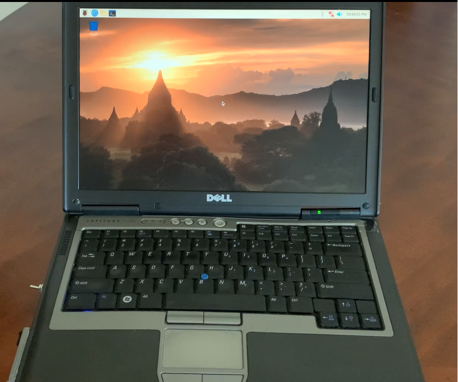

- Dell Latitude D630 - Keyboard (Teensy 3.2 and 4.0 example)

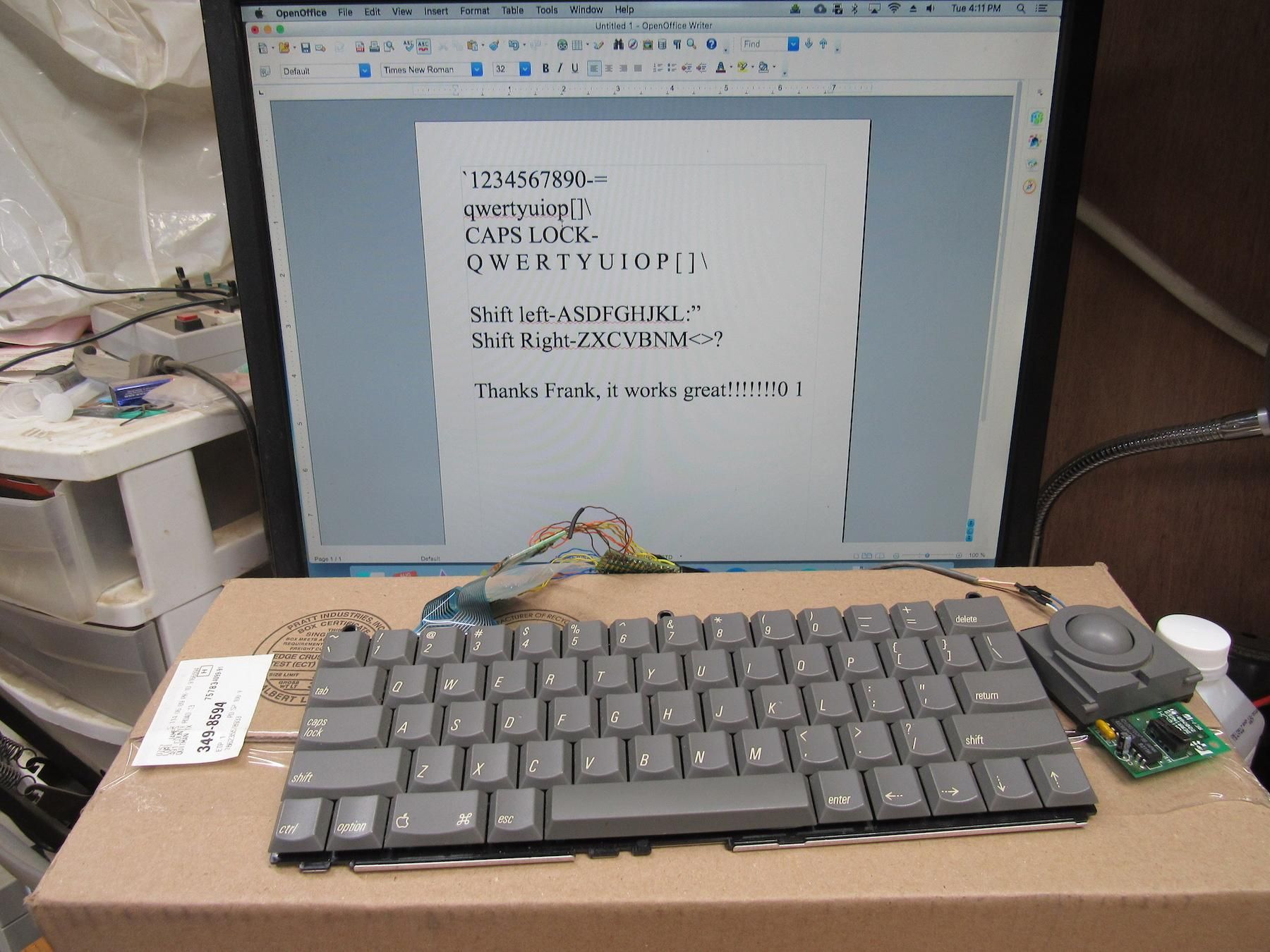

Apple Powerbook models 100, 140 through 180, and 520 - Billy67 used a Teensy 3.2 to talk to these Apple keyboard and trackball units. Pictures are in the "I made it" section at the end of this Instructable. The trackball uses an Apple Desktop Bus (ADB) interface that is controlled by the Teensy after it scans the keyboard matrix. The Teensy code for the Powerbook 100, Powerbook 520, and for Powerbooks 140 thru 180 are at my repo.

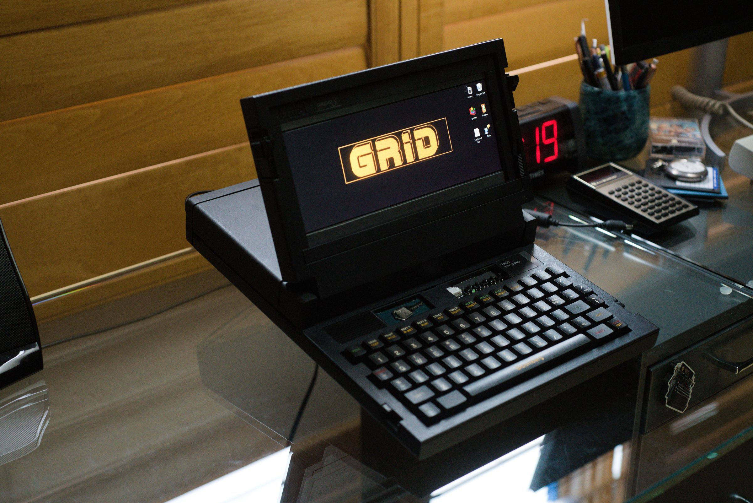

GRiD 1550 UK - SimonT192 has modified my Teensy LC code to work with a GRiD 1550 keyboard with a UK layout. This laptop has a rotary encoded "IsoPoint" mouse which has been converted to USB using a Teensy LC. The code for the keyboard and mouse are in a folder at my repo along with a PDF describing the operation. Watch Simon's YouTube video for a very detailed description of his "Aliens Sentry Gun" GRiD laptop build. Hackaday featured his project as well.
GRiD 1550 US - Chris has modified his GRiD 1550 US keyboard to work with a Teensy LC. The code for the keyboard is in a folder at my repo along with a PDF. Chris was also able to get the IsoPoint mouse working.
GRiDCase 3 - Lucas and I converted his Bloomberg GRiDCase 3 laptop keyboard to USB. The project documentation and code is at my repo. The financial spreadsheet keys were redefined but some of the unique keys were maintained. It does not have a right shift key. The “CODE” key acts as a Figure Shift which allows access to the symbols on the alphabet keys. Shifted numbers do not send anything but shifted alphabet keys send the upper case letter. Lucas is accustomed to this key layout thanks to his day job of repairing typewriters. Check out his project writeup for a blow by blow description.

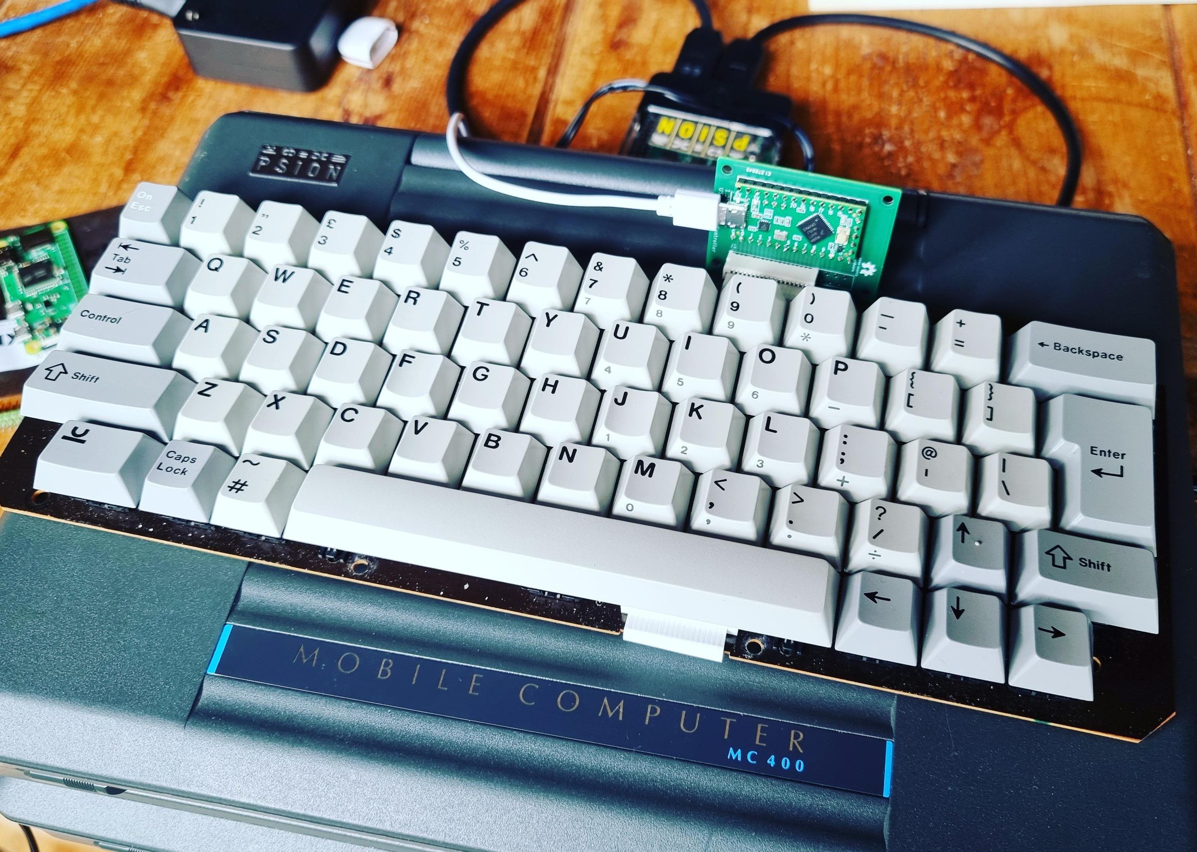

Psion MC400 - Zedstarr used my Teensy LC code on the mechanical keyboard from a Psion MC400. His website gives all the details including a video link.

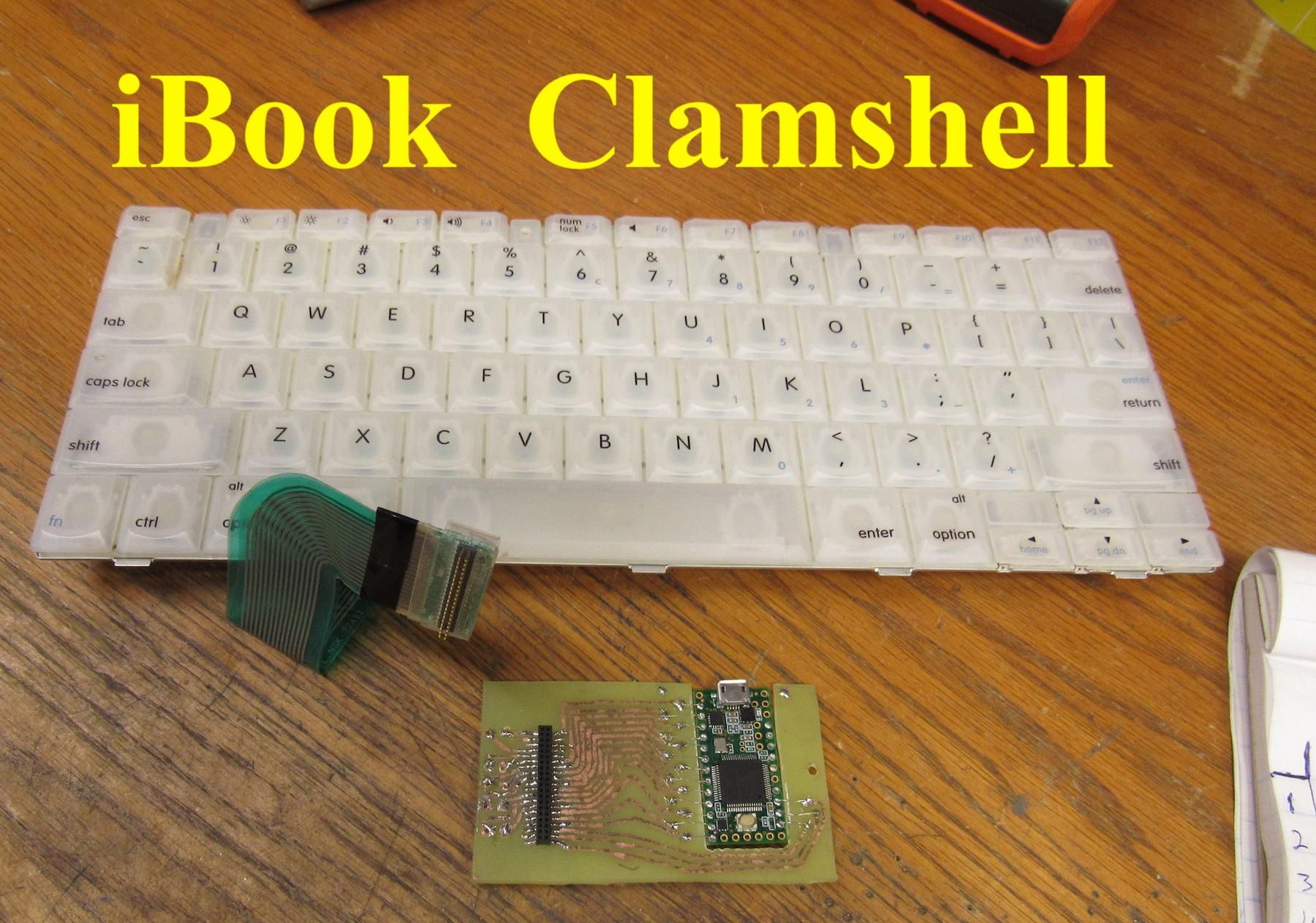

Step 18: Apple IBook G3 Clamshell
"Billy67" has used my code and circuit boards to convert several Apple keyboards to USB. Many are documented in the "I made it" section at the end of this Instructable. One of those keyboards is from an iBook G3 clamshell which has a special 40 pin connector on the end of its FPC cable. Because of height restrictions in the clamshell laptop, the Teensy must sit inside a cutout in the board. Wires or "U" shaped header pins tie the Teensy I/O's to the connector board. Billy did some experimenting and found part number HDR127MET40F-G-V-SM-DR mates up with this keyboard perfectly. To build a prototype, he etched his own circuit board with fine pitch traces drawn freehand with an ink pen (wow, that's hard core). If you're like me and haven't used PCB etchant in a few decades, you're going to want a circuit board file to send to a fab house. For this reason, I created the Eagle layout file "iBookG3Clamshell.brd" for sending to OSH Park and a zip'ed Gerber file for fabrication at JLCPCB. These files are available at my repo. Billy fab'ed the board at OSH Park and assembled it with a Teensy 3.2 and connector (see above). Billy has added power, ground, clock and data wires from the Teensy to a PS/2 touchpad (from a Dell). The keyboard and touchpad Teensy code for the iBook G3 is at my repo.

The Keyboard_Scanner_Dual board shown above uses a Teensy LC on one side for keyboards like the Panasonic Toughbook CF-48 which has 2 separate 1mm pitch FPC cables that are on top of each other (not side by side). The other side of this board is for a Teensy 3.2 with 1mm and 0.8mm pads for FPC connectors placed side by side. This Eagle file can be downloaded below or from my repo. To order the board from JLCPCB, use the gerber zip file at my repo.
If you don't mind soldering a lot of wires, you can use the FPC breakout board shown above for one of the keyboard FPC connectors and put the other keyboard FPC connector and a Teensy on the regular board. Wire the breakout board to the Teensy per the tables on Step 14 so you won't need to modify the software. The front side of the breakout board will accept an FPC connector with up to 18 pins and either a 1mm or 0.8mm pitch. The back side of the board is for a 0.5mm pitch FPC connector. This approach will allow you to place the breakout board in whatever location is needed by the keyboard cables. The FPC_18pin1mm.brd Eagle board file can be downloaded below or from my repo. It only costs $3.75 to order 3 boards from OSH Park. The gerber zip at my repo can be used to order from JLCPCB.
Your final option is to make a new layout like I did for the Lenovo 380 Keyboard shown above. A complete design description and Eagle board/schematic are at my repo. This could serve as a starting point for a new board layout and you can add other circuitry like a trackpoint interface or backlight connector.
Step 20: Building a Keyboard Base
The easiest way to mount your keyboard is to use the base from the original laptop, (see the Fujitsu case above). If you're not going to use the original laptop case, you can build a custom base out of various materials. Luigi Caradonna has made a stunning marble base using the CNC milling machine from his work. If you are lucky enough to have a 3D printer, you can make a custom case like TheGreenMamba's beautiful X61 Thinkpad keyboard. His 3D print files are at thingiverse. tcaschy has made a few 3D printed cases including the one shown above for a Blackberry keyboard with a Raspberry Pi Zero and LCD. Ben has the files for his T420 3D case at his repo. Harjoc used acrylic to make a cool see-thru base. The Thinkpad T43 keyboard shown above has been mounted on a wood base by "Than the FIT man". All of these projects are documented further in the "I made it" section at the end of this Instructable. I made a Thinkpad T61 keyboard base using 3 sheets of 1/4" plywood. Each sheet had its own cutouts to provide a cavity for the Teensy and wire routing. I've also built wood bases for the Toshiba 2415 keyboards that are documented at my repo. Warren has chiseled a wood base for a Dell Inspiron 1420 that is pictured on the PJRC forum with code at his Github repo. The Fujitsu Lifebook 755Tx keyboard has a thick backside so it can sit on a desk without any case. The picture above shows how I routed the dual FPC cables into a project box that houses the Teensy 3.2. The Fujitsu keyboard project documentation is at my repo. The Logitech K120 keyboard can be re-wired for control by a Teensy as shown in the picture above and documented at Hackster.

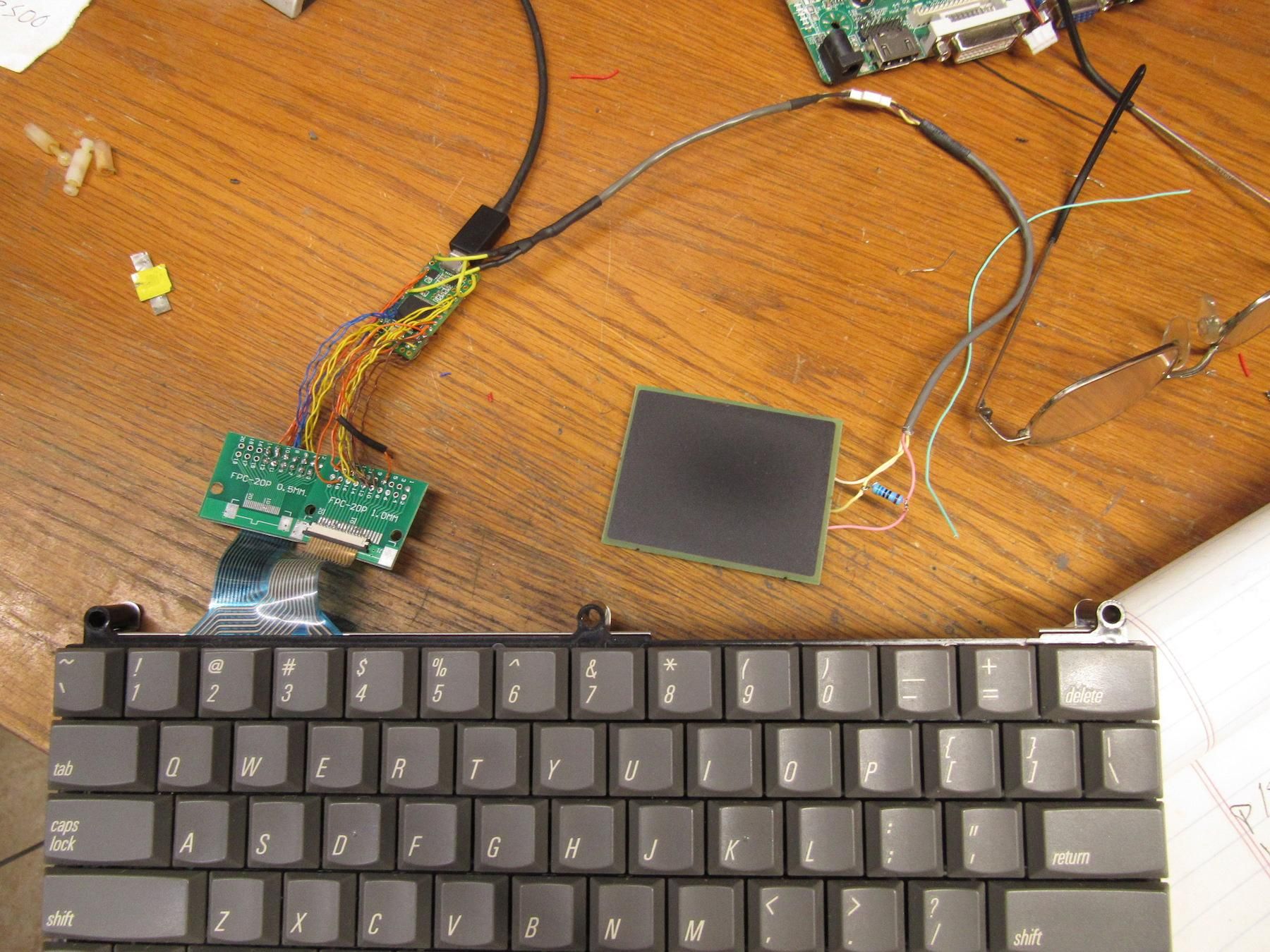

The PS/2 signals from a laptop's pad/pointing stick can be converted to USB with an off-the-shelf converter as shown in numerous videos. If you also want to convert a laptop keyboard to USB, then it makes sense to combine these tasks with a Teensy and only use 1 USB port. PJRC has created mouse functions in Teensyduino so the USB coding is easy. I wrote code for the Teensy that bit-bangs two I/O pins to make the clock and data for the PS/2 bus. You can download my PS/2 code below or from my repo. In the Arduino IDE, under "Tools", set the code to the Teensy model you are using and to "Keyboard+Mouse+Joystick". Compile and load the code into the Teensy. The code sets the pad/pointing device to be polled at a regular rate to see if any movement or button presses have occurred. This makes it easy to merge in with the keyboard scanning code, which also repeats at a regular rate. The Thinkpad T61 shown earlier uses this method to merge the keyboard and PS/2 trackpoint code. The Dell Latitude D630 keyboard code below or at my repo has also been merged with the touchpad code. It can be difficult to figure out the clock, data, power, and ground pins if you don't have a schematic so I wrote a step by step procedure to identify the pins. This guide also describes how to use a level translator for the clock and data signals when using a Teensy LC or 4.0. The schematic for the translator is shown above. For a quick and dirty cable solution, the clock, data, power, and ground wires from the Teensy can be soldered directly to pads on the board. If the board has an FPC connector and cable, you can use one of the breakout boards from the previous step to provide access to the 4 signals that go to the Teensy. An example of a breakout board for a Toshiba 2415 touchpad is shown above. The composite keyboard and touchpad code for the Toshiba 2415 is at my repo.
For you "real" coders, the interrupt driven trackpoint routine at Martin Prochnow's Github repo is more efficient than polling. This code has been merged with my USB keyboard code (with many improvements) by Ben for his Thinkpad T420. His original Github repo has his initial code and circuit board but he just couldn't stop there. Now his second repo provides the code, circuit board files, and 3D printer files to make a keyboard that's USB and Bluetooth capable. It has rechargeable batteries in the case along with lots of weights to hold it in place.
A trackball, touchpad, or mouse that uses the Apple Data Bus can be converted to USB using the Teensy code at my repo. This code was merged with the keyboard scanning circuitry for a Mackintosh Powerbook 140 shown in the "I made it" section at the end of this Instructable.
I2C touchpads are becoming more popular in modern laptops. This 2 wire clock and data bus can be directly driven by the I2C pins of a Teensy so no bit-banging is needed. My Hackster.IO touchpad tutorial describes how to determine the touchpad's I2C address and registers using a Raspberry Pi. Example I2C Teensy code for a basic touchpad and for a very complex Azoteq TPS65-201A-S touchpad can be downloaded from my repo and merged into a keyboard scanning routine. The Azoteq touchpad shown above has tons of features described in it's datasheet and it only costs $5.70 at Mouser.
Before pads, nubs, and trackballs became popular, the GRiD 1550 laptop of the 1980's used a metal rod below the space bar called an IsoPoint. The rod can be spun clockwise or counterclockwise for the Y cursor movement. This spinning rod is rotary incremental encoded with 2 signals. The rod will also slide left or right for the X cursor movement which also has two rotary incremental encoded signals. The Teensy code at my repo translates these 4 signals into USB. A complete description of this project is at my repo.

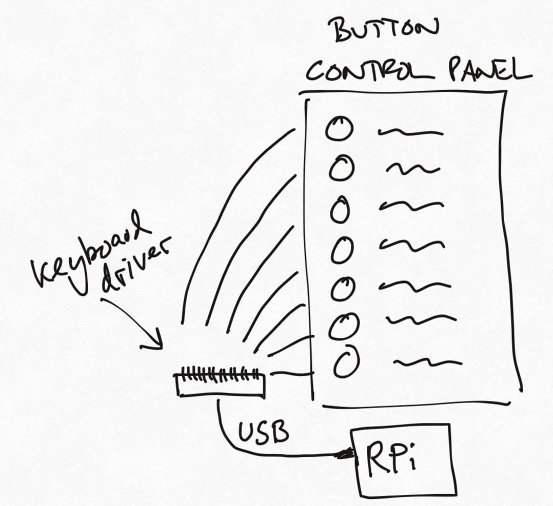

Nice project. Question: I like to use old USB keyboards as microcontroller input, which means soldering wires onto the keyboard PCB which is really tedious and doesn't work very well. Since you work with USB keyboards - would you have any idea of how to do this better? I am using a raspberry pi as a backbone of a "control panel" in my home, basically a larger board of mechanical buttons that each have a home automation function. Using the GPIO's on the raspberry is limited and using a USB keyboard control means access to a lot more inputs.
Reply 3 months ago
I assume the old USB keyboard no longer works so you can’t
just connect it to the Pi and code it to watch for a certain key sequence. First
I would take the keyboard apart and find how the switches are routed to the
microcontroller. This may be with an FPC cable or with Mylar plastic sheets
with metal traces. Neither one can be soldered directly so you’ll need a
circuit board. If there is an FPC cable, use my PCB with an FPC connector (or
buy one from Aliexpress) so you can use an ohm meter to find out which 2 traces
are connected when you push a key. It will take a long time so it would make more sense to follow this
Instructable and install a Teensy with code so it can find out the key
connections for you. Then put the matrix into the USB keyboard routine so it
can report any key sequence you want. If you try to have the Pi do all the
scanning for every key, it will use all its GPIO and still may not have enough,
plus you have to write a lot of new software.
If the broken USB keyboard has Mylar plastic sheets, the
trace connections are done differently and you’ll need to build a matching circuit
board like I did for this Logitech keyboard: https://www.hackster.io/frank-adams/teensy-controls-a-logitech-keyboard-fujitsu-ergotrac-a0e308
The metal traces on the Mylar sheets are very resistive so
you’ll need to use high value discrete resistor pullups (not the built in
pullups).
Hope this helps

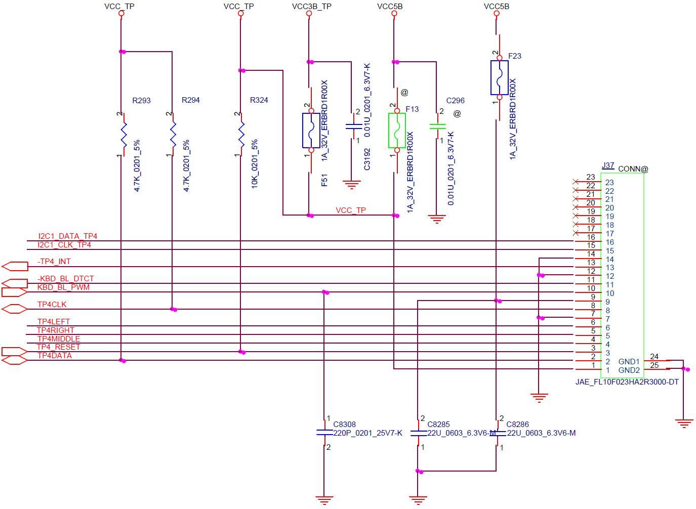

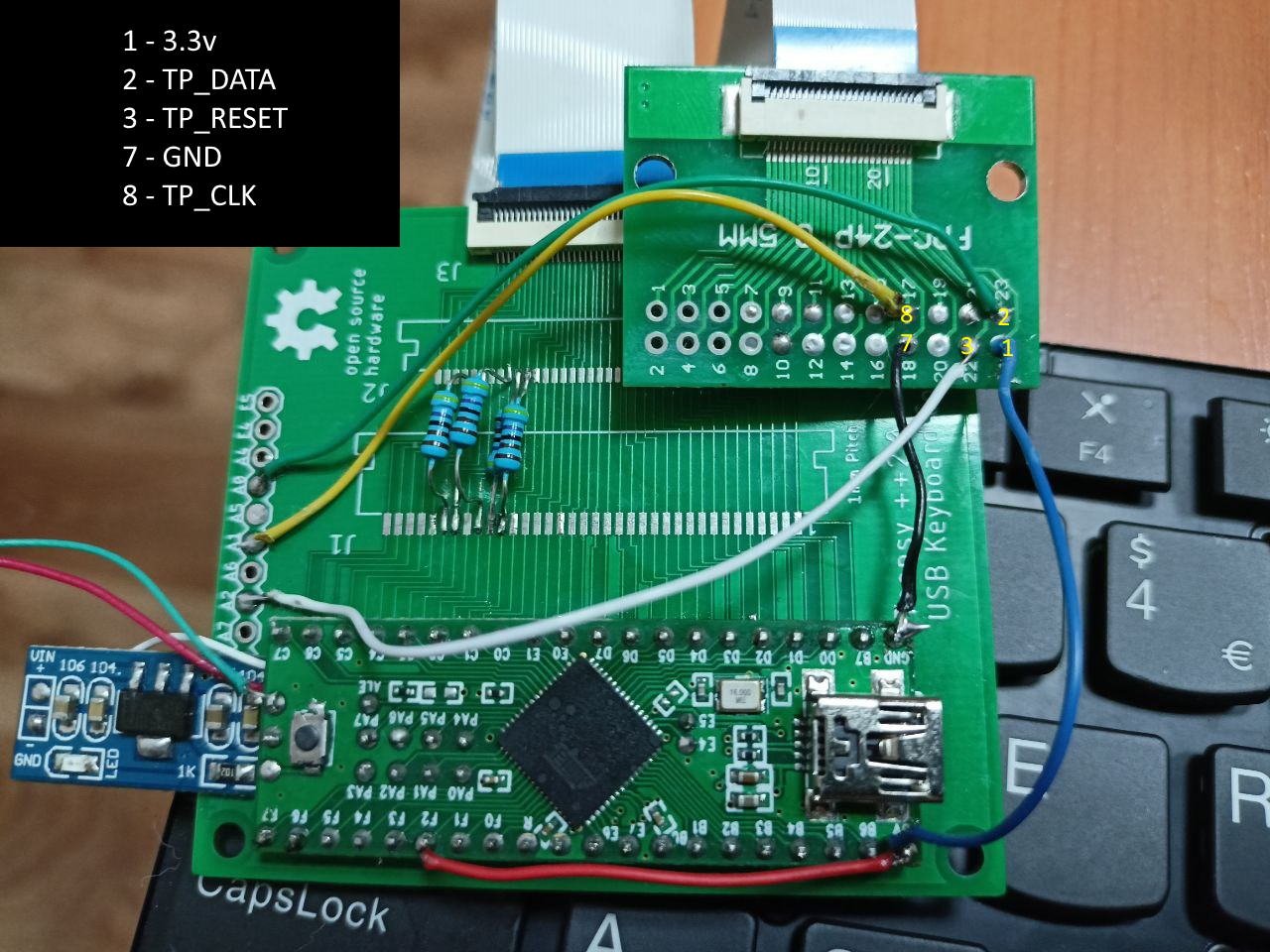

Question 7 months ago
Lenovo x1 carbon 2017/2018. I have a problem with determining the i2c trackpoint address. I uploaded i2c scanner to nodemcu v3, connected 1 pin to 3.3v, 7 pin to ground, 15 and 16 to GPIO5:SCL and GPIO4:SDA, but don't get an response with address from trackpoint. I have tried with 4.7k resistors on data/clock and without, result is the same. Сould it be that i2c is missing on this keyboard and I should use the usual method?
i2c scanner that i use: https://github.com/jainrk/i2c_port_address_scanner/blob/master/i2c_port_address_scanner/i2c_port_address_scanner.ino
Answer 7 months ago
You may be right and the i2c is missing and you'll have to use the ps/2 signals instead. Besides, getting ps/2 working would show that the trackpoint is alive then you can go back to trying i2c if you want. I've only used a Raspberry Pi to do the i2c address scanning so I'm not familiar with your method. Are you sure you've got the FPC pin numbers correct? I've seen breakout boards that silk screen pin 1 on the left and others (including mine) that have pin 1 on the right. If you're not sure, trace the ground and power pins back to the trackpoint circuit board to confirm you're good. Is your reset signal just pulled up? Some people put a large cap on the trackpoint reset pin so it wakes up low and eventually is pulled high. I prefer to tie the reset signal to an output pin on the microcontroller and have the code give a nice long/clean logic low reset at power up.
Reply 6 months ago
Thanks. I tried steam mode and the trackpoint worked. Now I am 100% sure that all pins are connected correctly. What is strange is that the trackpoint does not work in remote mode and I have no idea why. I tried the code for remote mode from "Touchpad_3p2.ino" and "Lenovo_T61_Trackpoint.ino" after replacing int with unsigned int and setting TP_DATA TP_CLK TP_RESET to 28 29 30. But it didn't give any results.
Reply 6 months ago
That's great news you got it working. I also had a touchpad that would not work in remote mode so that's why I developed the code for stream mode. I figured that most laptops only use stream mode so they may not have spent any time getting remote mode to work.
