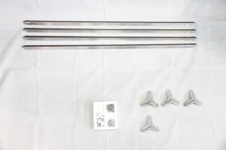

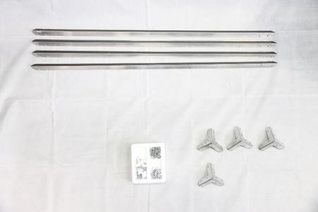

I could not find the assembly instructions. decided to write it myself
Connecting corner 8 pcs.
Aluminum profile with magnetic tape 1000 mm 8 pcs.
Aluminum profile 400 mm 4 pcs.
Transparent acrylic 1000х400х2mm 4 pcs.
Transparent acrylic 1000x1000x2mm 1 pc.

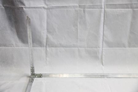

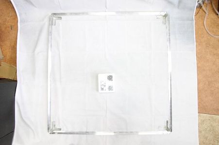

Step 1:

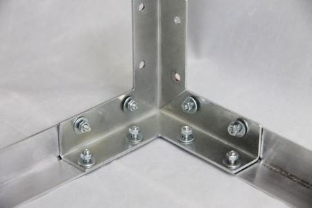

Place the elements as shown in the image. We connect with nuts and bolts.

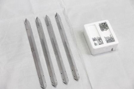

Step 2:
We attach a 400 mm aluminum profile to the existing square as shown in the image.

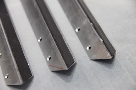

Step 3:
Repeat step 1. Place the elements as shown in the image. We connect with nuts and bolts.
WARNING: Pay attention to the location of the tapes.
Step 4:

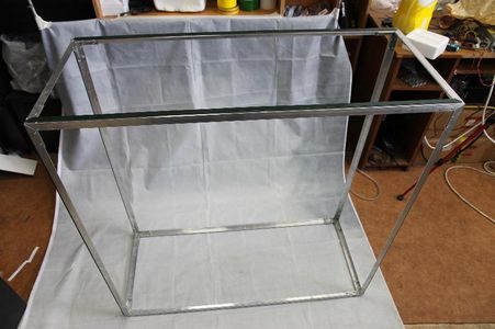

We combine the resulting in the 2nd and 3rd steps, as shown in the image. We have assembled the frame.

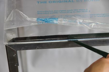

Remove the protective film from one side of the acrylic. We place it with the side without a film to the frame. Centering. Raising the acrylic slightly, remove the protective film from the adhesive side of the magnetic tape. We glue it.
We repeat this action from all sides.

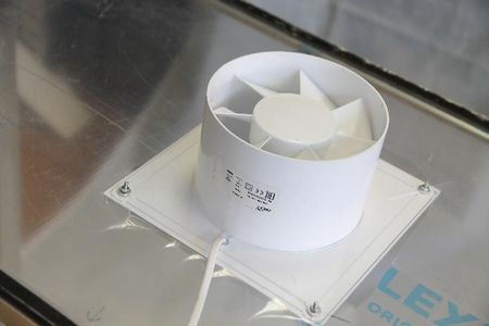

Step 6:

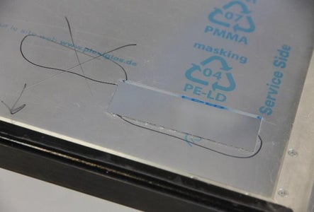

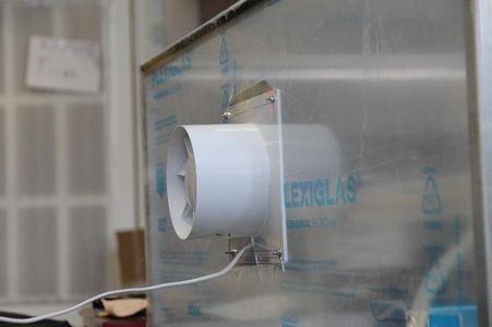

In one of the side walls we cut out a seat for the exhaust fan. We also cut out a place for the cooling tubes and wiring.
Step 7:

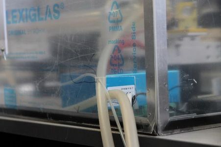

We install the box on the machine. We install an exhaust fan in a previously prepared place. We carry wires and pipes for cooling
