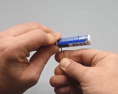

Step 4: Install the Spring
To enable the internal flip flop circuit in the 555 timer, connect the trigger connection (pin 2) to the GND (pin 1) connection. The vibration sensor part is attached to these 2 pins.
To start, mount the iron ball to the spring by soldering it to it. I chose soldering because with gluing it is not certain whether the spring and the ball touch each other and therefore it is not certain whether they conduct.
Now solder the other side of the spring to pin 2. Make sure that the spring is as straight up as possible.
The first part of the vibration sensor is ready, I will show the other part in the next step.
Step 5: The Ring
A ring of conductive material is placed around the ball. I have opted for I chose a piece of copper wire that I still had lying around here. I made the rounding by twisting it around a round object (solder tin holder). You can of course also use a marker or something similar for this.
Place the ring around the ball and connect it with the GND connection (pin 1).
The vibration sensor part is now ready. When you shake the sensor, the ball hits the ring and the 555 timer switches on the output.
