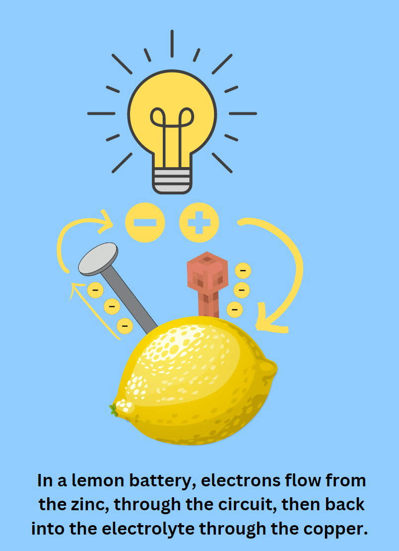

Zinc is an element that normally contains 30 electrons, two of which lie in the outermost energy level. Electrons in this outer shell are called valence electrons, and the number of valence electrons in this outer shell is a major determinant of the atom's behavior. This is why elements on the periodic table are grouped by number of valence electrons -- they tend to behave similarly.
Electrolytes are substances that have a natural charge (either positive or negative) when dissolved in water. When in the presence of an electrolyte, such as lemon juice or salt water, the zinc atoms readily shed their two valence electrons. This is a process known as oxidation, and is the same thing that happens when iron (or many alloys containing it) are left outside for long periods of time.
When iron is left outside, the metal reacts with the moisture in the air and gains what we call rust. The iron atoms change into iron oxide. The iron loses some of its valence electrons to the oxygen, which bonds with the iron and the hydrogen in the moisture to form hydrated iron oxide. Similarly, when zinc atoms are exposed to salt water, they shed their valence electrons, and are no longer an electrically neutral atom -- they become positively charged zinc ions (Zn2+). Importantly, with the zinc, the electrons are not given to a different atom, they are sent out of the zinc, and into the circuit, powering it, and eventually returning to the electrolyte.
The Journey of Electrons
- When a zinc electrode is placed in a battery, the first electron leaves the zinc atom and enters the external circuit, starting its journey through the circuit. The external circuit can be a light bulb, a motor, anything that requires electricity.
- The electron then travels through the external circuit, providing the electric current that can be utilized to power devices or perform work.
- Eventually, the electron reaches the other electrode (cathode) of the battery, which is usually made of a different material such as copper.
- At the cathode, the electron combines with positive ions from the electrolyte, completing the circuit and maintaining charge balance.

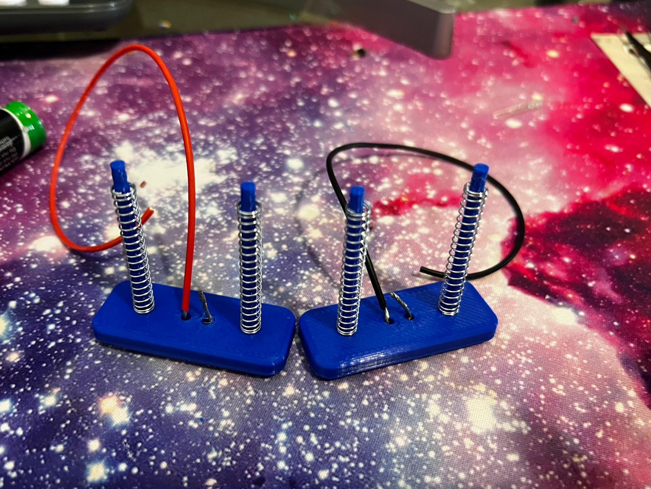

Attached to this step are two files. One is a base, and the other is a spring-loaded pressure plate, of which you'll need to print two. The pressure plates help everything stay compressed and in the center of the base. I could have designed this to only need one spring-loaded plate, but I wanted the cells to be in the middle of the base.
Go ahead and print the files and set them aside until after step 3.

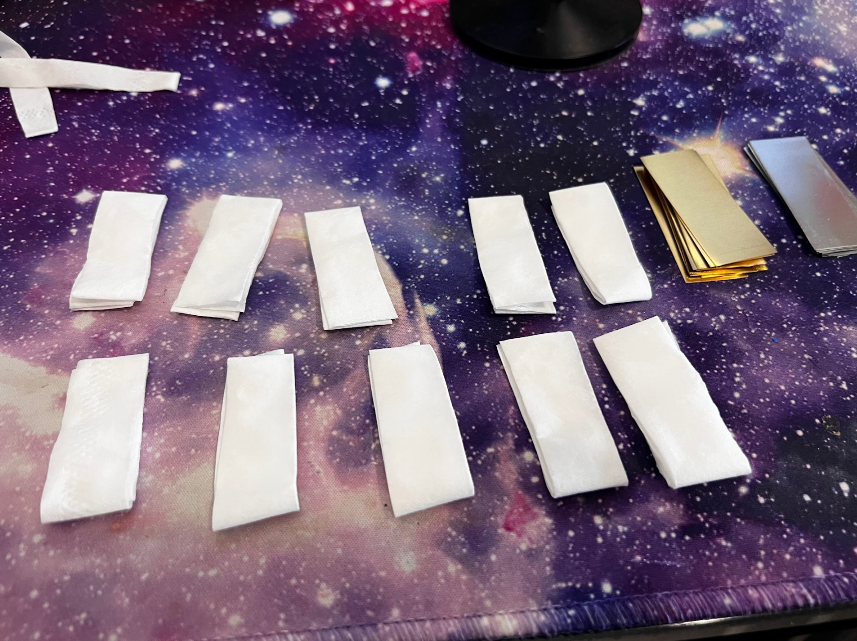

Take your porous substance and cut it into pieces that are as big as your zinc/copper strips, which, for reference, are 50x20.2mm. I used folded-up tissues for my porous electrolyte. The tissues were four-ply and are folded up to be four layers, although it doesn't matter that much, as long as they're thick enough to separate the cells' layers.
If the tissues are too big, they could touch with the other layers and short out that cell.
If they are too small, the metals from one side of the cell could be touching the other, essentially also shorting the cell.
You want them to be just the right size and thickness.

Also, take two wires (~250mm each) and strip off 15-20mm off the ends. The sliding elements have holes for stripped wire to be threaded through and around, and if you have enough wire, you can loop it back around to keep it tied. Here's how the sliders should look:

What I call a "voltaic sandwich" is just one cell of the pile. From bottom-to-top, I put one zinc sheet, two tissue folds, and then a copper sheet. This makes one sandwich. I then put it into the voltaic pile such that the zinc is left and the copper is right. You can then add several more sandwiches, ensuring that you insert each one in the same orientation, with zinc on the left.

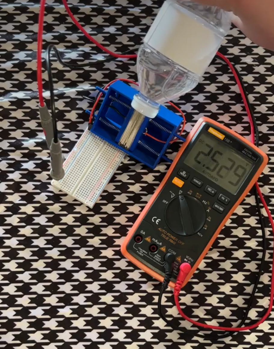

I cut a small hole in the cap of my salt water bottle, which makes it easier to drip the electrolyte onto the sandwiches. If you're using the vertical version of the voltaic pile, you'll probably want to lie it down flat on its side until it's ready.
Also, I crimped the two terminals into a DuPont connector so that I could easily plug them into my breadboard, but this is obviously not required, just makes things easier.
Activating the Battery

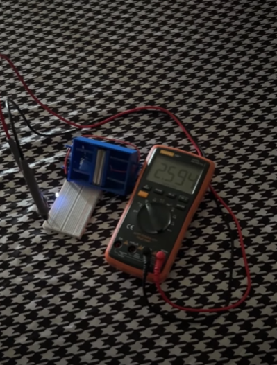

From here, it's simple. Just get your circuit setup, and slowly drip your electrolyte (the salt water) onto your porous sheets. I did this very lazily -- if you spill, it might short circuit the battery for a few moments, but it's a low current and doesn't matter. In fact, it's kind of cool to see the LED flicker when the battery shorts out. Here's a video of me lighting an LED with all ten cells of my voltaic pile:
As you can see, I only got about 2.6v out of it. I have a feeling that some of my porous layers were extending beyond the dimensions of the metals, and were touching other cells, causing their voltages to not add as expected. I was expecting around 7 volts. The discrepancy could also be due to some diseconomy of scale that I am not aware of.
At any rate, it was enough to light the LED. It was very neat to see a completely closed system generating electricity in a way that I could see. Rechargable batteries make sense logically, you "fill" them up with electricity, and then they provide it later, but this was something different entirely -- this is a chemical reaction happening in real time. Technically most non-rechargable batteries are also chemical reactions, but there is something about one that is made by hand that makes it all the more enthralling.

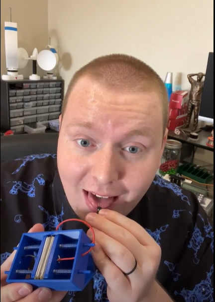

Out of curiosity, I touched the two terminals to my tongue, and sure enough, I could feel the electricity as it bridged from one terminal to the other through my tongue. It was the exact same feeling as doing so with a common 9V battery, although of starkly lower magnitude.
