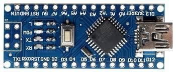

1xArduino nano (or any oder Arduino board)

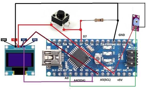

Step 2: Wirring Diagram
Make the connections of the components according to the diagram below
