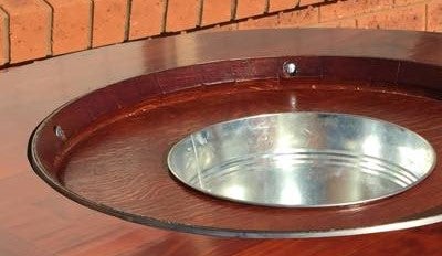

Step 2: Adding the Wine Bucket
I bought a 25l bucket (which must have a lip to prevent it from falling through the hole). I removed the handle. I found the centre of my wine barrel and cut a circle the size of the top wine bucket under the lip. I drilled a pilot hole and used a jig saw to cut this out.

Step 5: Securing the Table Top
To secure the top to the barrel, I lined up the table top up with the barrel and drilled a hole through the barrel and into the inner circle of the table top and inserted large bolts to prevent the top from moving. I used the router to remove part of the underneath surface so that the lid balanced on the rim of the barrel and not the surface of the inside which was not level on any of my barrels.
Step 6: To Get a Good Fit on the Table Lid
I have made a few of these tables and found this was the best way. The picture on the top was a nice fit and the picture on the bottom had a slight wobble, because the inside of the barrel was warped. I chiselled out the centre of the lid so that I could add a pull latch. I sanded the surface ending with 320grit, stained it and added 3 coats of satin varnish. And to finish off I added I strip of aluminium cut to size to finish off the edge. Which just finished off the look.
