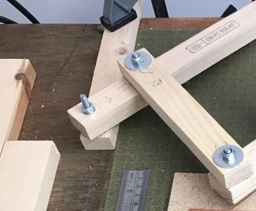

Step 3: Drill the Holes
The screws/bolts that I'm using are M6 so I drilled the pivot holes with a 6mm drill bit. These hole locations and sizes need to be as accurate as possible so I used a Pillar Drill although it would be possible to do it by hand with a hand drill.
Step 4: Assemble the Pivots
As the joints need to be able to pivot you can't tighten the nuts and bolts that are used to make the pivots. So I used a type of locking nut, called a Nyloc, so that I can tighten each one up just enough so it isn't floppy but not so much that the joints can't rotate. The Nyloc then stops the nuts being loose and undoing themselves as you use the pantograph.

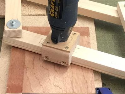

Step 8: Mounting Block
This step may very depending on the type of tool you want to fit. My Rotary Tool has a large plastic thread on the end so I made the mounting block design to suit this.
Firstly, fit the engraving tool you want to use and measure how far it sticks out of the machine, this will determine how tall (or deep) you mounting block needs to be. When the whole thing is assembled, the cutting point of the tool needs to be able to stick out of the bottom of the mounting block as much as you want to engrave.
I cut a notch from a block of wood that was wide than the pieces I used to make the pantograph so that one of the pantograph arms fits in this slot.
I then used a large hole saw or spade bit to drill a hole through. For me this needed to be large enough to fit the nut that normally screws onto the end of the tool.
I took a piece of 3mm hardboard and cut it to the same size as the rest of the mounting block. I drill a hole in the centre as close to the size of the outside of thread on the Rotary Tool. For me this was just a bit smaller than the thread, so it actually screwed onto the tool, I then screwed the normal nut back onto the end to clamp it tight.
I drilled 4 small holes in each corner so I could screw this hardboard to the top of the mounting block.

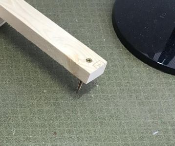

Step 10: Tracing Point
As accurately as you can, drill a hole slightly smaller than your screw, so the screw threads can bite into the wood, but not so small that the screw will split the wood. You must drill a pilot hole, as so close to the end of the wood, it will almost always split.
Make sure the screw is long enough to pass through the wood and to just almost touch the shape to the traced. You can screw the screw in or out to adjust this.
I used a 4mm wood screw.

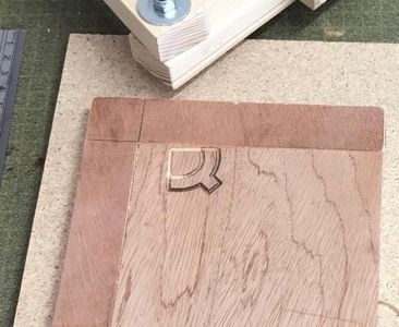

Step 11: Give It a Go!
I found something to hand that was about the right size and had a clear outline, turned on the tool and traced the tip of the tracing screw around the outline of the shape.
I was fairly happy with the outcome for a first test, turns out my tool was blunt, hence the black burn marks, that, and I wasn't moving it fast enough. That aside, the actual accuracy was a pleasant surprise considering how crude the pivots are.
