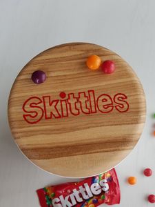

Polish the cover until it looks great and feels smooth. Pull a rubber band on it. It is going to be a sealing rubber.
Fit the cover to your container and draw a pattern on the top.
Step 3: Step 3

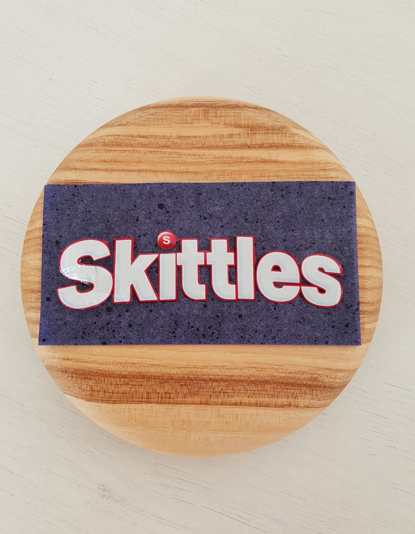

Transfer the Skittles logo image onto the board using a piece of carbon paper. I found the image on a specialized website. Nail or clip the paper to the board.
Contour poorly drawn lines with a pencil. Paint it with a brush. Apply the original color pattern.
