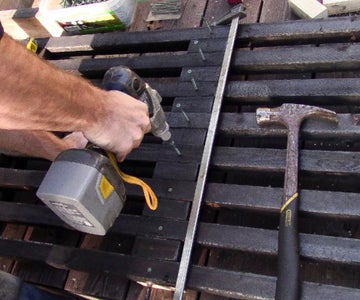

Step 4: Assembly
I did have to make a slight adjustment to the base boards as the wood did appear to shrink after the burning process which is why you’re seeing freshly cut ends. After that was marking the holes and drilling the holes. This will help the boards clamp down into place. Nails can be used, but I prefer screws instead as they’re stronger and boards can be removed if a replacement is required. To screw the boards down into the base boards, 2 1/2” screws are used. To screw the perimeter board to each of the slats, 3” screws are used here.
Only the slates have screws going down from the top and from the side, the spacer blocks only have one screw as they’re purely for aesthetics. The screws on the top are kept in line but are also far enough in where they’re not interfering with the 3” screws.
And as you can see I’m also using the clamp to keep everything tight and in place.
Installing the inner boards, these are the 2x4s. This will prevent any flex in the center, along with keeping the platform more rigid. The centerline measure from the outside edge is 23” which leaves the spacing very close to being even.
All the spacer blocks were installed, drilled, and then everything was screwed into place.
After that was the opposite side. Depending on your application, you may need to make adjustments and even do a test run stepping on the platform to determine where you can minimize any flex.
