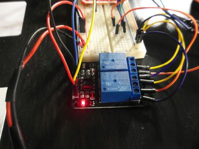

Step 4: Set Up Dual Channel Relay Module
Now, we set up the dual channel mechanical relay. On the relay channels, in front of each terminal, you will see text like 'NO1', 'COM1', 'NC1' (or something similar).
  • NO means Normal-open
  • COM stands for common
  • NC stands for Normal-closed.
It’s useful to understand what happens when wiring to each of these terminals:
Normal-open is the port to connect a wire if you want it to be ON when you activate the relay channel. When it’s activated, the circuit continues through the COM port to the motor (or whatever it is you’re powering).
NC is similar to NO. It completes the connection when the relay is OFF instead of ON.
We’re going to do something a little different than normal with this relay. Typically, motor shields and H-bridges are used for high-speed performance. But since we only need to switch polarity based on an event (the tap of a card or tag), we can simply use the relay as an H-bridge instead.
Wire it up as follows:
  • Arduino 5V to relay VCC pin
  • Arduino GND to relay GND pin
  • Arduino D7 to relay S1 pin across a 220 ohm resistor
  • Arduino D6 to relay S2 pin across a 220 ohm resistor
  • 12V GND to NO1
  • 12V GND to NO2
  • 12V VCC to NC1
  • 12V VCC to NC2
  • 12V VIN/VOUT from COM1/COM2, alternating, but never both ON or OFF simultaneously.
Once it’s all properly wired, you’ll have a raw but functional access control system with NFC to add an extra level of security for your home and family.
