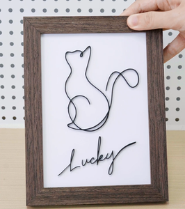

Step 6: Remove the Protective Film and Attach
After the job is finished and the acrylic cools down, peel off the protective film from the back of the cut piece. Use adhesive or double-sided tape to attach the outline to a photo frame—or any surface where you want to display it.
Remove the Protective Film and Attach It To Any Places You Want.
