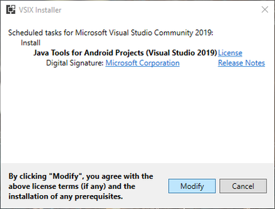

  1. Select the Extensions tool bar at the top of the window
  2. Select the option to Manage Extensions
  3. Search for the extension called Java Tools for Android Project (Visual Studio 2019)
  4. Select the download button next to the extension
  5. Close out of the extensions window
  6. Close out of the Visual Studio window
  7. You should be prompted with a windows called VSIX Installer, select the Modify button
  8. After a few seconds a new windows should appear saying "Modifications Complete", close out of that window
