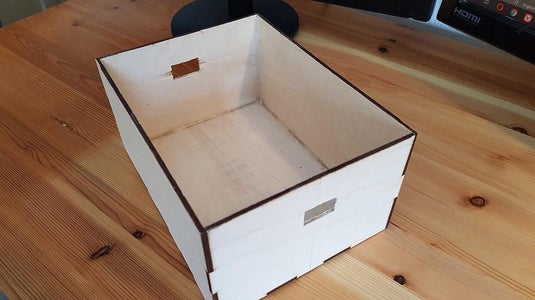

Connect the servo voltage line to 5V on the Arduino, GND to GND and the signal line to pin 3 on the Arduino. The box needs to have holes for the locking bars to slot into.
Make sure they are directly opposite each other across the box.

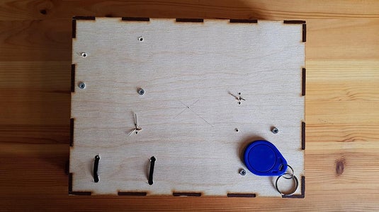

Step 2: Creating Box Mounting Points
The box lid needs to have attachment points for the Arduino, RFID reader, power pack, servo and locking bar hinges.
The servo needs to be located in the centre of the box lid so that the locking bars, which are pulled in and out of the locking holes by the servo, can reach both sides of the box equally.

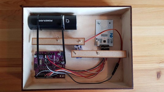

Construct and attach locking bars, using paper clips or other material as hinges and fixings for connecting to the servo horn. Make sure that the bars can move backwards and forwards smoothly as the servo rotates, and that they can move the correct distance to slot into the locking holes.
Use nuts and bolts to attach the RFID reader and Arduino to the inside of the lid (the blue RFID tag shows the location of the RFID reader on the inside of the lid).

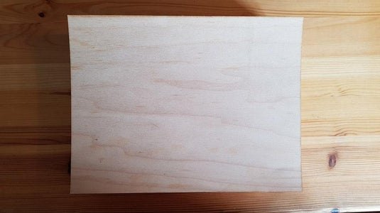

Step 3: Optional Tidying
The outside of the lid can be made neater by covering with veneer, or something similar.
Step 4: Attaching the Power Pack
Attach the power pack, using cable ties or other methods, and make sure all the connecting wires between the devices are held out of the way of the locking mechanism.

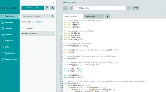

Step 5: The Code
The software is written in the Arduino IDE. Note: Make sure to set the Device and Port to the correct ones under the “Tools” menu.
Once the program has been uploaded to the Arduino, the RFID tag and card that are supplied with the module can be used to test locking and unlocking the box, and making the alarm sound when the wrong one is used.
// The required libraries for the program#include <SPI.h>#include <RFID.h>#include <Servo.h>// Setup arduino pin definitions #define SS_PIN 10 #define RST_PIN 9#define SERVO_PIN 3#define BUZZER_PIN 8// Initialise the RFID readerRFID rfid(SS_PIN,RST_PIN);// Initialise an instance of the Servo class called "lock"Servo lock;// serNum is used for reading and checking the ID numberint serNum[5];//This integer should be the code of your RFID card / tag int cards[][5] = {{182,106,89,165,32}};bool access = false;bool boxOpen = true;int attemptCount = 0;bool alarmOn = false;// Function to read the RFID card / tag and determine whether access should be grantedvoid readCard() {  if(rfid.readCardSerial()){      for(int x = 0; x < sizeof(cards); x++){        for(int i = 0; i < sizeof(rfid.serNum); i++ ){            if(rfid.serNum[i] != cards[x][i]) {                access = false;                break;            } else {                access = true;            }        }        if(access) break;      }  }}void setup() {  // put your setup code here, to run once:  Serial.begin(9600);  SPI.begin();  rfid.init();    lock.attach(SERVO_PIN);  lock.write(5);}void loop() {  // put your main code here, to run repeatedly:  // The "if" statement only runs if an RFID card / tag is detected  if(rfid.isCard()){       /*        * Check whether the read card serial number matches the saved serial number        * If the serial number is incorrect, access = false, otherwise access = true       */       readCard();       /*        * If access is set to true and the box is currently locked, the servo will move to                                              unlock the box.        * If access is set to true and the box is currently unlocked, the servo will move to          lock the box.        * If access remains false, a warning buzzer will sound.        * Each time an attempt is wrong, a count is increased. Once this count reaches 3, an          alarm will sound.        * The alarm can only be silenced by using the correct RFID card / tag.        */       if(access){           attemptCount = 0;           if (!boxOpen) {              lock.write(5);              boxOpen = true;              delay(1000);           } else {              lock.write(45);              boxOpen = false;              delay(1000);           }                  } else {           attemptCount = attemptCount + 1;           if (attemptCount < 3) {              tone(BUZZER_PIN, 330, 500);              delay(250);              tone(BUZZER_PIN, 311, 500);              delay(250);              noTone(BUZZER_PIN);           } else {              alarmOn = true;              while (alarmOn) {                tone(BUZZER_PIN, 784, 1000);                delay(250);                tone(BUZZER_PIN, 659, 1000);                delay(250);                noTone(BUZZER_PIN);                                if (rfid.isCard()) {                  readCard();                 }                                                if (access) {                    attemptCount = 0;                    alarmOn = false;                }              }           }       }  }  rfid.halt();}
