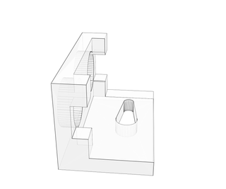

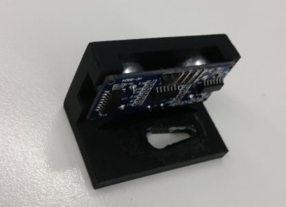

As my inspiration for this project hadn't included any sort of bracket to hold the ultrasonic sensor in place, I decided that it would be a good idea to 3D print this bracket to give the finished design a cleaner look, and make everything easier to put together. The section which holds the ultrasonic sensor ended up fitting relatively tightly around the ultrasonic sensor, doing a good job at keeping it in place. However, the hole cut out underneath for the servo arm to go in is slightly too big, so I needed to add a lot of glue to keep it in place. But overall, it works quite nicely and gives the design a good look.

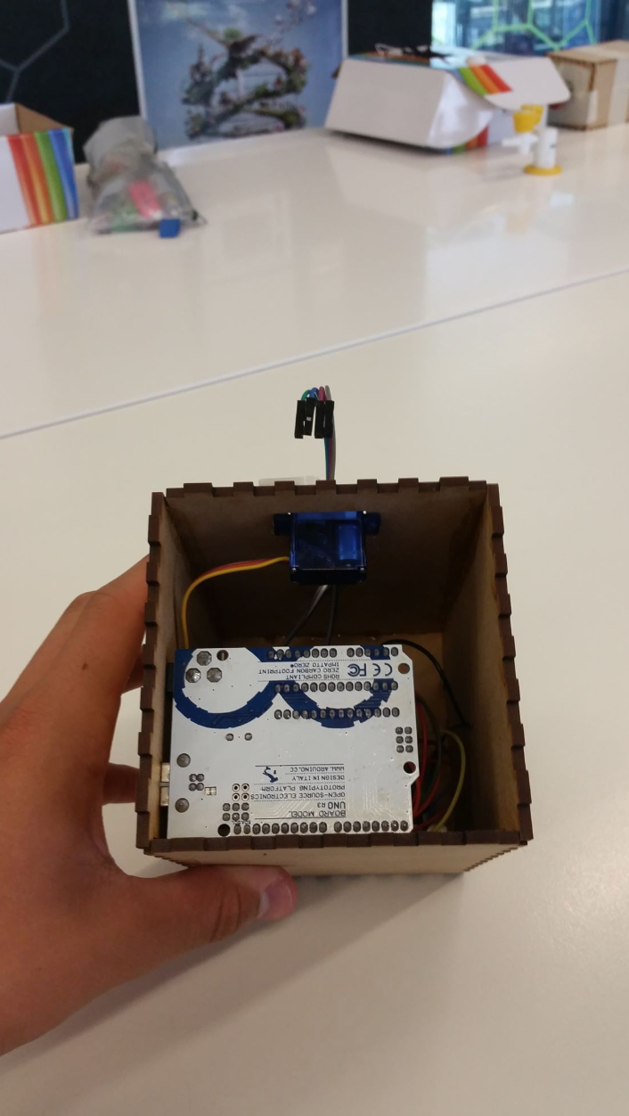

This box was implemented to give the project a clean and professional look. It does a good job at concealing all of the wires and the arduino board itself. To create the actual box design, I used the website http://www.makercase.com/ to get the finger edges to join each side of the box together. This was a very useful website as it saves me heaps of time and is very easy to use. As you can see from the finished product of the radar, I cut out measured holes in the side and top of the design to allow for the parts of the project which needed to be on the outside. This included holes for the servo, which I stuck to the box from underneath, wires to the ultrasonic sensor, the buzzer, and to the arduino board itself from the computer. It is quite big (there is a lot of room in the box) but at least it gives you a lot of room to work with and nothing is ever cramped. If you were to make a box design yourself, you could definitely make ti smaller and everything would still fit.

As per the arduino code, the ultrasonic sensor has to be wired to pin 10 and 11. Though, as well as with all ultrasonic sensors, it also has to be wired to the ground and 5V pin. The servo has to be connected to the pin 12 (myServo.attach(12);) and it also has to be connected to the ground and 5V pins. As for the buzzer, it just connects to ground and the analog output pin A0. Once you have attached all the necessary items for the radar, your circuit should look somewhat like the diagram above. Also, try and keep everything neat! Once the circuit is in the box, it the wires are all extremely tangled, there is the chance a wire or two can slip out of place and cause your radar to malfunction. It happened to me, and I found keeping it neat from then on reduced these occurrences.

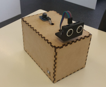

Assemble the laser cut box using strong super glue, so there is no chance that it will slip apart after you have finished the radar. I found it easier to use some books to hold up one of the sides of the box so I could then glue the adjacent side. After holding it there for 5 or so minutes, I would then continue to the next side and so on. Remember no to glue one of the ends on, as you will obviously need to put in and take out the radar. Once the glue on your box has hardened, you can continue with your assembly. Firstly, I glued the buzzer to the top of the case (shown above) and then when that was dry, I fed the wires through the relative hole and connected them to the buzzer. When it came to the servo, I glued the little wings of the servo underneath the box, so just the top part of the servo was showing. This allowed the whole thing to look aesthetic while also maintaining it's practicality, with the head of the servo readily available for easy access. Then with the ultrasonic sensor in the 3D printed bracket, attach the bracket to the servo using glue so that it is secure. Once this is done, your project is ready to test!
