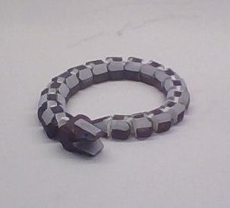

Alright. This is the second to final step. It is also the longest and hardest step. For this step, you are going to create the head for your model. First, you are going to get a cone, cut off the top, cut it in half, then make it taller and thinner. All of this is shown in the first three pictures. Then, you are going to lay it down on the round side. This is shown in the fourth picture. Then, you are going to copy and paste it, flip it over, and then put it on top of the other part of the mouth. This is shown in the fifth picture. Then, to create the other part of the head, you are going to get a cylinder, put some bevel on it, and then attach it to the mouth pieces. This is shown in the sixth picture. If there are small pieces of the mouth sticking out of the cylinder like in mine, then you can use a hole to cut them off. This is shown in the seventh picture. You can make eyes however you like, but I used holes to create mine. This is shown in the eighth picture. Then, you can add any decorations to it that you like. I just added more plates onto mine to go along with the cyborg theme. Next, check the size compared to the rest of the model to make sure it looks good. This is shown in the tenth picture. The next step is to create the hook. You are going to get the same hook from the regular pieces, but then you are going to add on some rectangles to make it longer. This is shown in the 11th and twelfth pictures. Lastly, you are going to attach the hook to the head. Attach it so that the actual hook is at the end of the body. Then, you are going to attach the head to the rest of the model. This is shown in the 13th and 14th pictures. Now the whole body is finished! You can see my finished model in the last picture.
Step 8: Exporting and Printing the Model
This is the final step! You are so close to having your own articulated 3d print! First, you are going to export your file in Tinkercad. Press the "export" button, and then choose .Stl or .Obj. Whichever one you use. I use .Stl, so that is what I am using for this. This is shown in the first picture. Import your model into the slicer of your choice. I use Ultimaker Cura. There is still room on my print bed for my model, so I made my model slightly bigger. This is shown in the second and third images. Now, choose your settings. I recommend 50-100 percent infill, rafts ON, and supports OFF. You can also use a brim instead of a raft. Now, slice your model. You can see that mine will take almost 7 hours and it will take about 18 meters of filament. This is shown in the fourth image. You can also look at your model in x-ray mode to see inside of it. I used this to ensure that nothing was fused together. This is shown in the fifth image. Now, your model is ready to print! I printed my model on an Ender-3 and with white PLA. After it finished printing, I colored it in with sharpies.
