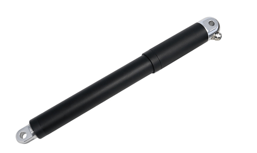

Step 2: Selecting the Suitable Actuator
Mike wanted to build a chicken coop door that utilized a water protected solution since the application will be exposed to outdoor environments. Opening and closing the chicken coop’s door did not require much force so an electric actuator with high force ratings was not mandatory. The PA-06-6-180 actuator was selected for its high Ingress Protection rating of IP67M to ensure water protection even while moving.
