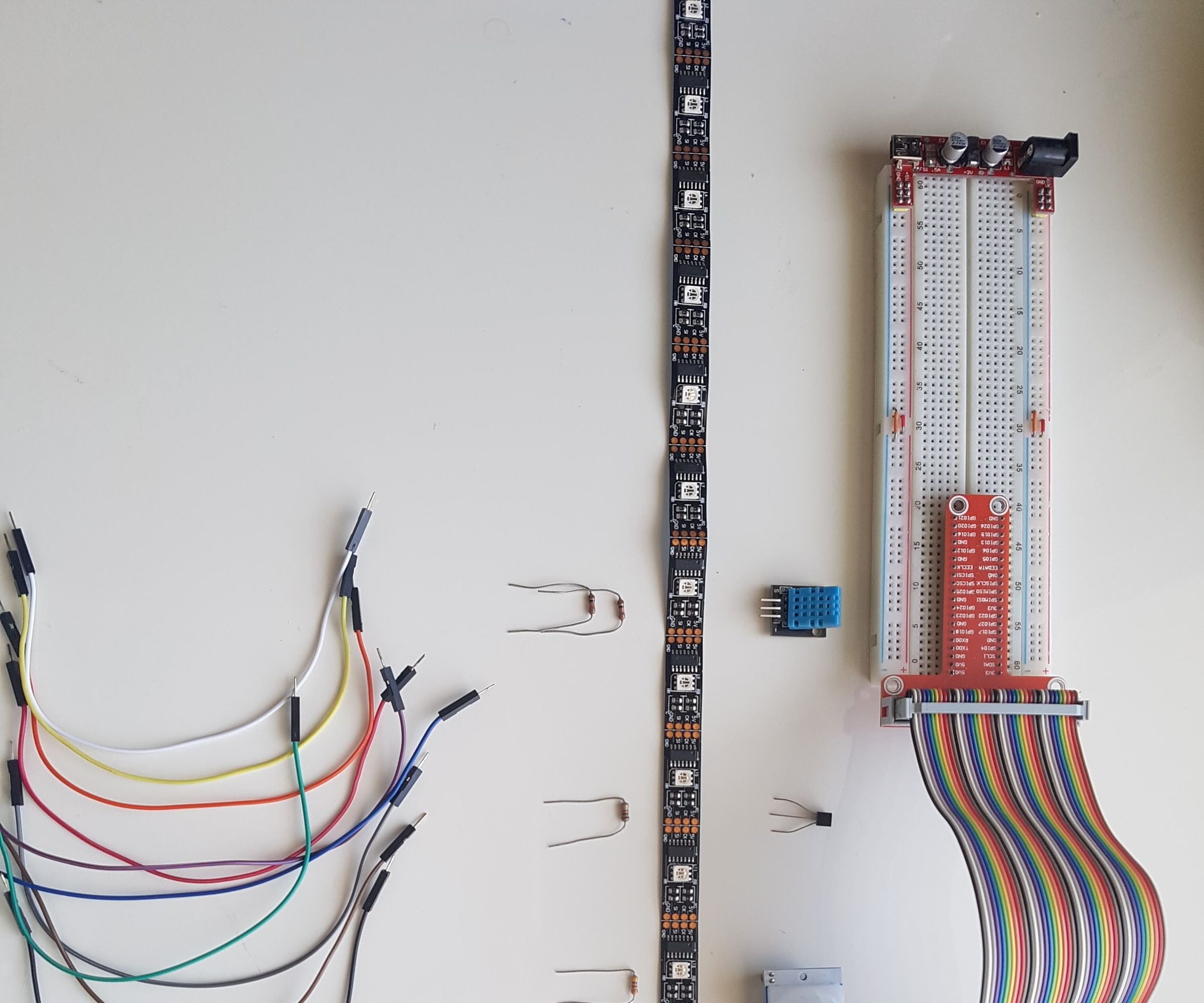

Step 1: The Components You Need:
Here's a list of the components you will need:
- Raspberry Pi 3 model B+
- 16GB micro SD
- Raspberry Pi supply 5,1V/2,5A
- Green LED
- Blue LED
- Buzzer
- LCD Display with I2C
- Touch sensor
- LDR
- MCP3008
- Steppermotor with driver (ULN2003A)
- RFID
- Breadboard
- Resistor 10K Ohms 5%
- 2 x resistor 470 Ohms 5%
For the housing I used:
- Wool
- Cardboard
- A glue gun
- Superglue
But you can also make the housing like you want it.
